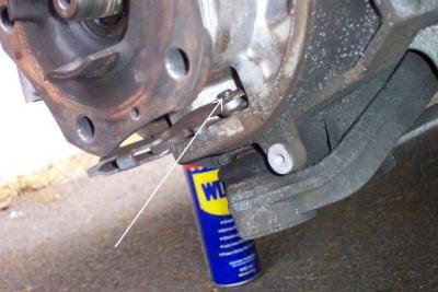

  21. Entire mechanism removed from cable and wheel carrier. Again, thanks, Glyn
  22. Maybe this pic will help. This is from the instructions I received from Glyn. There are two pins. One attaches the two ratchet pieces together and is not removed. The other pin attaches the entire mechanism to the cable end and is removed.
  23. I understand your problem and all I can tell you is that the cable does simply pull out the back of wht wheel carrier. Mine did not require excessive force to remove. Assuming you have the other suspension pieces and axle loose from the carrier, you could try tilting the carrier upward to see if that helps you with removing the cable. tried
  24. Pry out part #10 . Parts 7 and 8 in the diagram are attached to each other and do not need to be seperated. The right hole on part #7 is were the part attaches to the cable. The pin and circlip I reference are not shown in the diagram.
