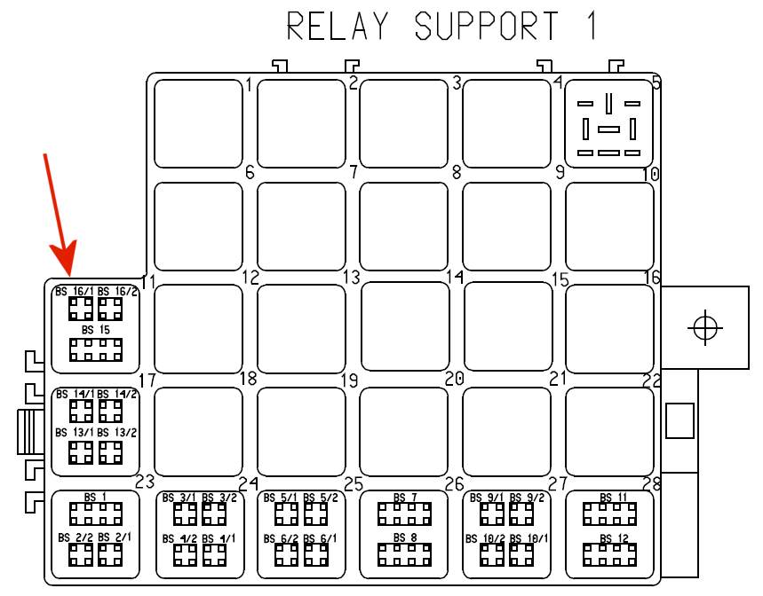

  7. Feed for the radio is Porsche Terminal 86s, which is ignition switched. It might be worth checking a Terminal 15 supply, which is also ignition switched. I have no idea if it will go off when cranking, but it is worth a try. You don't say model or year of your car, but this is from the 2002 wiring diagrams which shows Bridge Plug 16/1 on the relay board, which is a Terminal 15 supply. Wire colour is Black/Brown.
