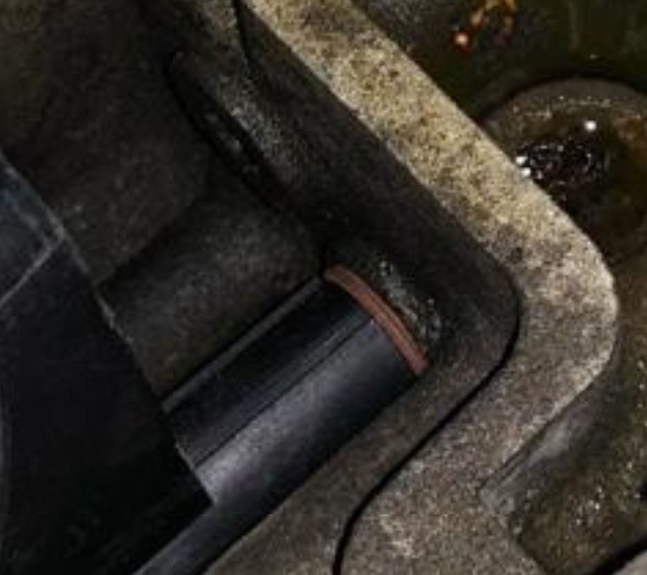

  12. This is why I'm wondering...see the seal on a new OE AOS? It is not like yours, at least from what I can make out.
  13. Very difficult to make this out. Even with the face of the AOS on the block, it still looks like a few millimeters off from the pipe being in the hole. Stumped me. Cram a shop light back there and get some better light on the subject.
  14. Is that an OE Porsche AOS? I remember seeing a picture of the old style AOS with the small seal on it, but the new OE AOS has a different seal. I'll see if I can find a pic.
