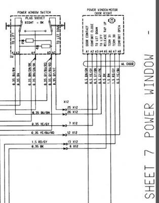

  3. This may help. It's the wiring diagram from a 986 01

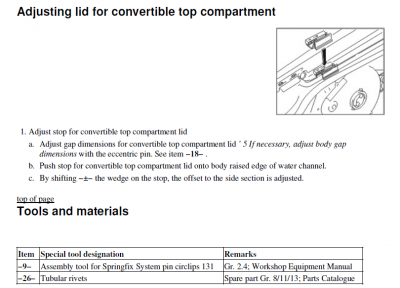

  7. This is a complete guess. I assume you mean the clamshell behind the convertibel top. If so, I guessing that you have a bad sensor that thinks everything is closed when its not. Try searching on 'adjusting the convertible top lid" See picture from shop manual
