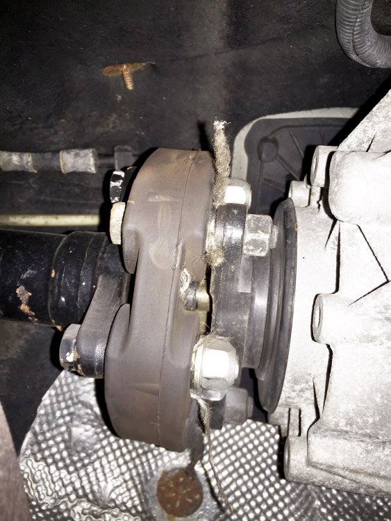

  6. Inspected the drive shaft and its bearing today. Visually i cant find anything wrong. But when i wiggle the shaft it sounds not good
  7. Its a porsche service. But i would not be surprised they just hammered it in. I am so p..... parts, parts, parts, and many things not done in the right way. This cardan shaft was just changed in case of. Thats now the result. You think you have a new part and drive save. Opposite happens.
  8. Juli 2015. so no more warranty :-( what a person can do wrong during changing a drive shaft if it was not a material failure?
  9. Have to find the bill. As lucky as i am i wouldnt be surprised if will be 14 month ago.
  10. The sad point in this story: the driveshaft and flex disc was replaced by my indy last year.

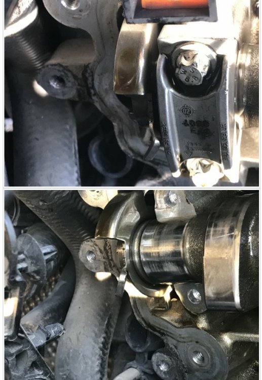

  16. Yes i am reading this. Many times already it has been discussed in the forum about the importance to take care about these cam shaft tabs when working on the valve cover. would like to ask what this tabs are doing? Would a problem causing constant rough running? Misfires? In all rpm range? In some specific rpm range? if the flap would be broken, how to replace / repair?

  18. Many times already it has been discussed in the forum about the importance to take care about these cam shaft tabs when working on the valve cover. would like to ask what this tabs are doing? Would a problem causing constant rough running? Misfires? In all rpm range? In some specific rpm range? if the flap would be broken, how to replace / repair?
