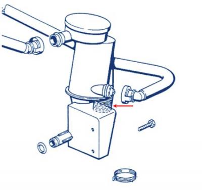

if i had to guess, even though it's not on bank 2, i'd go with the oil separator bellows. see pic below.

So if the rubber boot is the culprit, Would it be ok to just replace the boot and not the entire oil separator?
nah. generally by the time the boot goes, the diaphagm inside the oil separator is probably shot, too. plus, the boot is the hardest part of the replacement process to install, so you might as well just replace the whole thing while you're at it. sunset imports has them for around $85.
this all assumes, of course, that the oil separator is indeed the problem. try the propane trick. my guess is that your RPM's will jump when you wave it around the oil separator.
