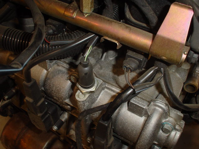

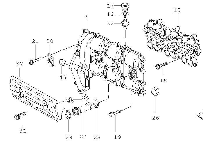

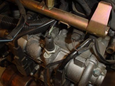

Have traced the sensor with the help of the photos+drawings and re-tighten the two cables attached to it (although they didn't seem loose...). Took the car for a quick spin and experienced the same problem when exiting hard from a corner... INDICATOR FAILURE on the obc and oil pressure drops to zero for a second or two. Any Ideas?????????
