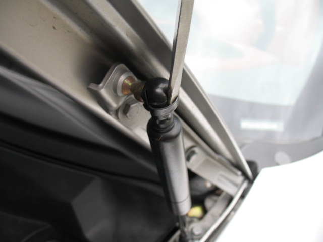

Got tired of the trunk lid hitting me in the head on my 10 year old Boxstir. Time to replace the struts, but not at Porsche prices. The struts are made by Stabilus. http://www.stabilus.com/default_e.asp   The Porsche part number is 996 511 551 01 - same for 996. Dealer has them for $39.28 each. Went to Pep Boys down the street from the dealer because Pep Boys sells Stabilus. Of course Boxster struts were not in stock, but I looked them up in the Stabilus catalog and the front is SG4060

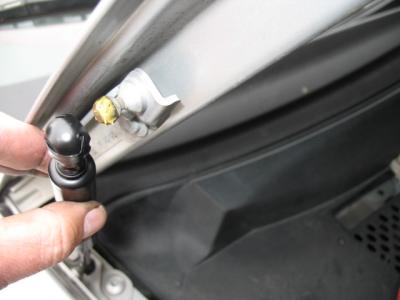

To get them off you need to stick a small screwdriver under the clip and pry it back just a little bit. Then you can separate the ball joint. Watch out you do not scratch the paint when the joint separates.
First pic is the screwdriver. Second shows both struts off. Third shows the dab of grease I put on the male joint. The female socket on the strut has a bit of grease in it, but I wanted some on the male part where the clip locks the joints together. To get the new struts on you can just push them on the ball joint - no need to mess around with the clip.
