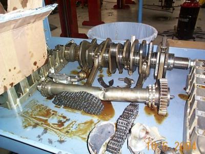

The thing is, for some Boxster Model Year 1999 cars, Porsche took defective blocks. Bored the cylinder out. Pressed in sleeves. Assembled the engine. Put it in a car. Sold it to the public. And some of the engines failed. I guess that is what you call keeping up with production. Then failures followed. Porsche has never admitted this happened, but there are pictures of it. Here is one of those pictures.
Then Porsche went from a double to single row bearing for the intermediate shaft, and the failures that followed. I cannot prove it, but I do see a bent intermediate shaft in the next picture.

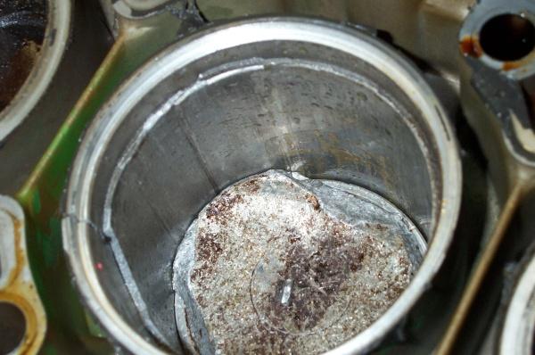

Anyone who has followed the engine failures knows that is is most often an intermix of coolant and oil caused by a failed sleeve. The sleeve has either cracked, broken or slipped causing coolant to enter the combustion chamber. This was due to porosity in the very expensive cast aluminum engine cases using a new cylinder manufacturing process whereby the cylinder itself was porous aluminum like a sponge and the pores were filled with a hard ceramic type alloy. This was called Lockasil. If defective cases were found in production, they were salvaged rather than scrapped by having a sleeve fitted most likely of Mehanite or cast iron and I would assume a plated Nicasil bore.
In my opinion, if you received a patched and salvaged case in your Porsche, whether buying new or used, you were getting short changed by the factory. You were paying a price for a product featuring a new and very expensive technology used in the manufacture of the motors promising near zero wear after over 100K miles of use and receiving something other than what was advertised.
