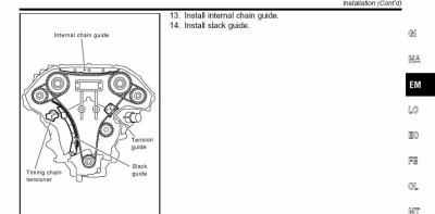

They are not that bad. I have done cams on a VQ35 (350z) which has a chain setup similar and it wasn’t that bad. I re-re’d the whole setup in around 3 hours having never done it before. Somebody with good mechanical skills to could do a HG on these cars in pretty short order I think. I have never done it so I really can’t say how easily, however I did a HG on the VQ35 as well and did it in 10 hours which included a lot of standing around and head scratching time. If I had to do it over again, would be faster. It looks complicated until you do it once or twice, then it's not that intimidating.
I still maintain that you can fix it cheaper than putting in a new engine. A motor is $4000 plus labor to re-re the motor. So for $4000 you should be able to easily do a HG figuring the same labor to pull the motor out and put it back in. There is no way the labor to change a HG on one side of the engine is more than $4000 the cost for a new motor. Even if the job took 20 hours it would still be cheaper than a new motor, no matter house you do the math.
Attached is the Boxster chain vs. the VQ35. Pretty similar and took me 3 hours to re-re it during a cam install. The VQ has variable timing on the gears just like a porsche does with variocam.
