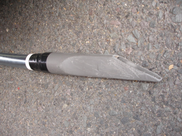

After doing the work I made up a simple attachment to fit a vacuum cleaner, it wont solve the problem completely but will remove a high percentage of the rubbish that finds its way in there before it turns to garden mulch and works its way between the two radiators. I plan to vacuum the radiators each time I vacuum the car from now on.
I cut the end of an old vacuum cleaner attachment shaping the aperture so it fits flush against the face of the radiators, connected it to a piece of flexible PVC pipe with some fittings from the local hardware store, about $5 all up. It works well.
