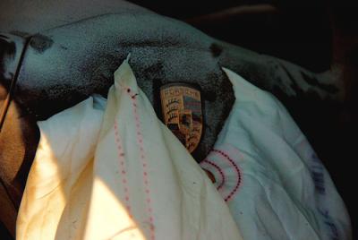

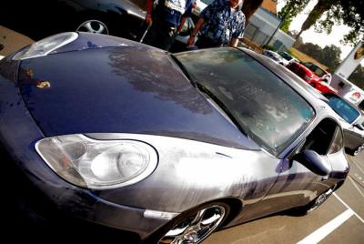

Pictures of my burned out 996
As you can see, it used to be a very nice car...I loved the Iris Blue and can't seem to find another one....but I'm pretty sure I'll be going up to a 996TT X50 as long as calamity has made up my mind for me.

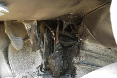

I asked the insurance folks if they had traced down the cause of the fire. The fellow was pretty candid and said that it was obvious that the fire was caused by an electrical short under the dash and that it would cost them around $1K to pay someone to trace down the exact cause....and since they were totalling it anyway and there was no reason to suspect arson or foul play, the were just totalling it with cause listed as "electrical fire".
I have gone on this forum a number of times inquiring about a periodic "hot smell" I was getting every once in a while....and I had Loren put the car on his computer and read out all the codes and there was nothing amiss. The only curious thing was that when I would lock the car, I'd get that little quick "beep" of the alarm horn that tells you something is open....when in fact I had systematically gone thru the car and ensured that there was nothing open. Loren's computer pointed to the front hood latch assembly...probably the alarm sensor there.....but the fire was under the dash and no where near the front latch. So the only thing I can think of is that periodic hot smell I'd get...but I thought it was coolant possibly being exhausted by the pressure cap.

This is only a guess... but I would guess that a previous owner had an after market radio put in. Then we he sold the car he took the 3rd party radio out and hastily put the original radio back in not taping the wires or checking for hazards. That would be my guess - because I do not understand why any "normal" Porsche part would not have just blown a fuse or at worst taken out just one component.

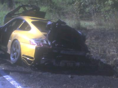

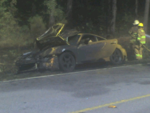

Chuck, gents, look at this one from two weeks ago down here near our local track of Kershaw, SC. My understanding is that the power steering line was pinched, and leaking fluid. Driving home after some tracking the steering was getting worse, pulled over on the dry (no rain in 2 months here) grass shoulder and caught fire. He had an extinguisher, but inside the trunk and could not get it. Owner is not hurt from what I know.

I don't know the year of this car - or whether he had the recall attended to but there was a Voluntary Recall addressed on TSB 2/03 A307 - Check Power Steering Threaded Connection -- dated Nov 24, 2003.
