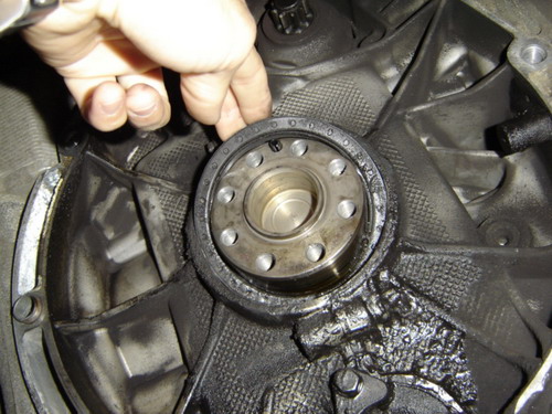

The 9K Mile 1999 model may have issues lurking that have not yet occured due to low miles, RMS failure, block porosity comes to mind. There are no free lunches.

According to the dealership that replaced the engine in 2004 when I was doing my research before buying, it was replaced due to "a seal leak," which when I asked if it was RMS failure, the service writer answered "yeah." As I've understood it, Porsche will fix your RMS problem twice, and on the third, they replace the engine altogether. This is what I think went down for my car when it was at 46K miles. And to answer your question, although there are volumes upon volumes of literature on the RMS design flaw, this does happen entirely too frequently on 996s in my opinion. Some experts estimate it happens to only (!!!) 50% of them, while others actually say it's just a matter of time for 100% to fail. What mitigates the bad news a bit is that it's relatively inexpensive to repair; and once it's done right, it's is supposed to be enough. "Supposed" to be.

rpf, better do a little more research, because even the 3.6 has had some RMS failures. I have seen as late as 2005 years have the problem.
