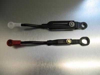

When I took the top apart, the rubber bushings that go in the pushrods had rotted away and disappeared long ago, so I'm not sure of the correct orientation.
Is this correct, or should it be inserted from the opposite side? In other words, does the thick part go on the outside like in my photo, or on the inside between the pushrod and the lever?
Also, I'm thinking that while I have this apart I should replace the red cap on the other side before it detonates. I have to take the pushrod off anyway to insert the new bushing. May I also have the contact info for the guy that sells the plastic caps?

Mark:
IIRC, the thick part of the rubber bush is supposed to be oriented so that it's on the inside, between the pushrod and the lever. I believe it's meant to minimize or eliminate any noise caused by the two metal parts bumping into each other during the rotation of the V-levers.
It would be a good idea to install two new plastic ball cups and keep the one red one that is still intact as a spare for emergencies.
I have sent you a PM for the contact info.
Regards, Maurice.
I would also love to have the email address of the gentleman in Belgium who has the plastic caps for sale.
One of my drive cables failed late last fall and this spring I took the car into a repair shop to fix. They suggested new drive rods and installed the new ones with the white caps. The mechanic managed to install them inside out and the adjusting nut hooked on the center hub of the drive gearbox. The car was returned to me this way and the result other than two bent drive rods was that one of the new white plastic caps exploded the second time I activated the roof. This time I just fixed it myself and reused the original rods with the red caps. They look in good condition but as everyone claims, I expect they will fail eventually.
