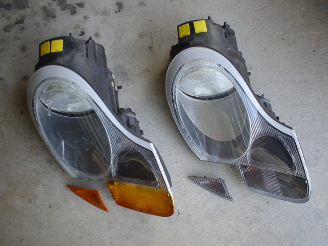

On the left is my standard amber Boxster light. On the right is a clear 996, but the amber diffuser has not been removed.

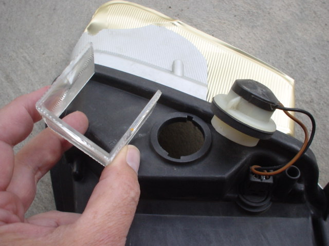

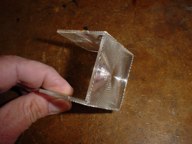

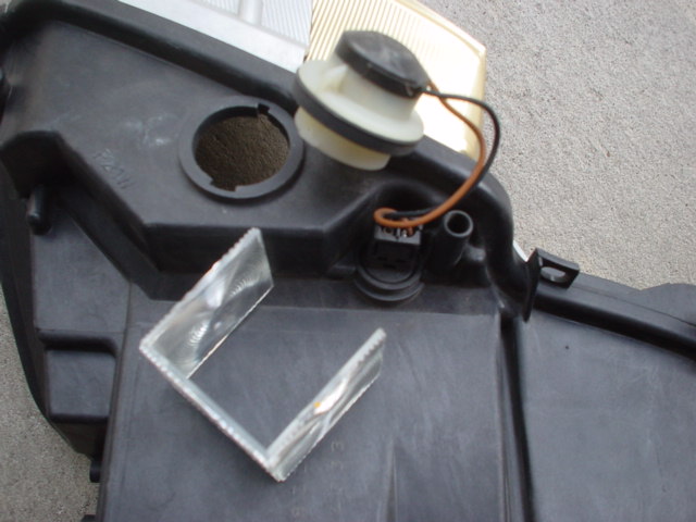

The internal lense has 3 sides to it.
These are pictures of the lense from an AMBER headlight. That is why the pictures of the lense show a CLEAR, not amber, lense.
These pictures are from the broken headlight on my 1997 with standard halogen amber headlights. You do not do the modification on this type of headlight.
The pictures are for illustration purposes only.
The headlight in the pictures was destroyed to get the 3-sided lense out in one piece. I do not know any other way to get the lense out in one piece.
The internal lense is way to big to pull out through the exterior bulb holder. You need to melt it, cut it, or otherwise break it into smaller pieces so it can be pulled out of the bulb holder opening.
