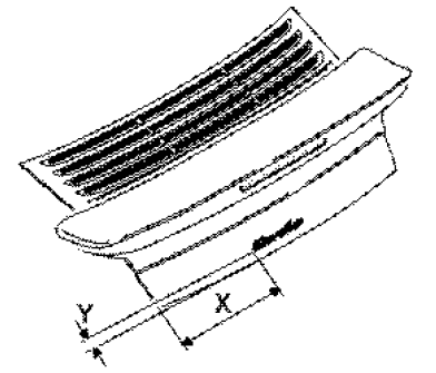

I have a 2001 996 turbo and within the first 5 days of owning it (Haven't even driven it yet) someone in my underground parking stole my turbo logo off the back and scratched up my paint in the process. Why they wanted it I have no idea, but my question is the foam and adhesive backing they left behind is it easily enough removed to install a new logo or is it better to just repaint, also on my motorcycle I had a permiter alarm installed which went off if someone even came close to it and has anybody installed something similar in their car. And if so what brand, I really don't want to mess with what the car already comes with I would just like to add an exterior motion detector to it. Thanks, someone please respond soon as I don't want this to only be the beginning.

You can remove the foam and adhesive backing by squirting some 3M Adhesive Remover (Red Can) onto where the foam meets the car body. It will slowly soften up the adhesive and allow you to wipe it off completely without damaging the paint.
If you are squeamish about doing it, try it on some hidden part of the painted body first (i.e., the inside of the gas cap lid, under a wheel well liner, etc.). I've always had good success with it and it has never damaged a finish on me.
