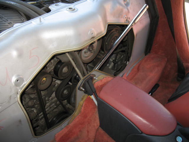

I have replaced 4 belts on different Boxsters and it is easy. Since the cover is off slide the seats forward so you have room.
You need a 24mm tool. If you are strong you can use a 24mm box end wrench. When I am by myself I use a 24mm socket on the end of a 2 foot breaker bar for leverage.
Put the tool on the nut on the spring loaded tensioner pulley and rotate clockwise. To the left and a little below is an idler pulley. You crank on the tool so that both pulleys touch each other and so the belt is loose enough to remove.
In the shop manual Porsche has a numbered sequence of how to get the belt off and on the 8 pulleys. I do it a different way.
Above the idler pulley is a deflector roller. With both pulleys touching each other slide the belt off the deflector roller, then release your tool and remove the belt. When you put the new belt on the belt goes on the deflector roller last.
Loren has instructions in the 996 DIYer section. 996 and Boxster are the same.

Here is a diagram I forgot I had that might help if you can see it.
You use the tool on #7 and rotate it until it touches #8. Then you slide the belt off #3. Porsche says to slide it off #8. Makes no difference.
After we do a belt change we start the car with the cover removed to make sure we did not screw up.
