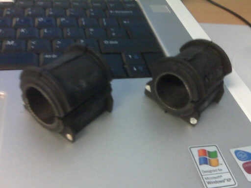

sorry Zeb - I had huge trouble finding a supplier that wouldn't cost and arm and leg to ship to me. So I ended up going with the stock parts (see pic attached).
I guess loads of copper grease will suffice for the bushings - and will I need to remove the wheels ?

One aspect I've found with ordering up urethane bushings, is mic every aspect(ID,OD, etc.). Lube with a mix of Wurth antiseize and marine grease. This way you'll never here a squeak or noise out of them. Pic shows a bushing I adapted to the rear of a Audi quattro(had to modify sway bar). Some of the bushings are not exact, and might need reeming. Sway bars sizes vary on the 986 due to suspension set-up, so mic(read: Starrett caliper)first.
