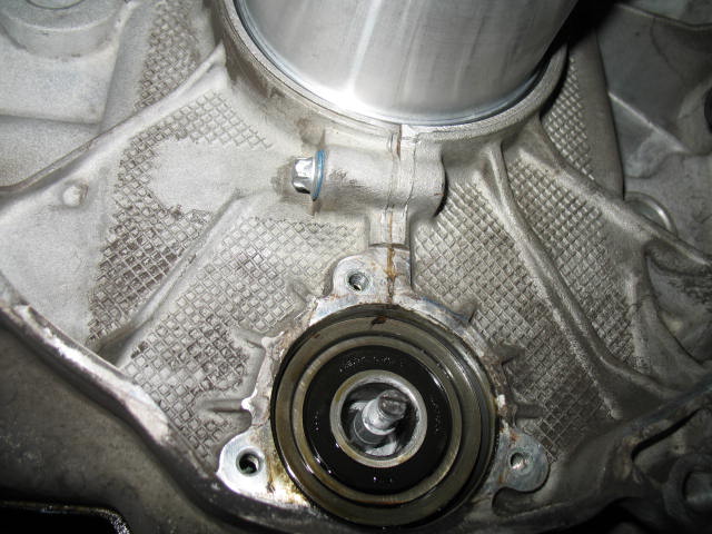

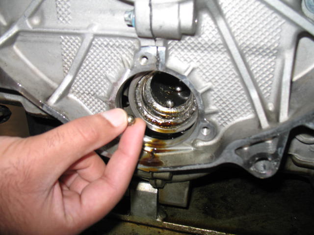

There is a ball bearing on the back of the engine case. The bearing fails and the shaft is no longer supported. First pic is a 1999 996 C2 with an intact bearing and no problem, and the second is a 2003 Boxster 2.7 with a failed bearing. The balls were literally falling out of the bearing.
This is why the first place to look is in the oil filter - to see if metal silver bits from a failed bearing have been trapped by the filter
There is a ball bearing on the back of the engine case. The bearing fails and the shaft is no longer supported. First pic is a 1999 996 with no problem, and the second is a 2003 Boxster with a failed bearing.

The other factor in my lay understanding is that the bearing is sealed. If you look at my first picture you can see the black seal. That bearing is exposed to engine oil so I do not know why a sealed bearing is used. This has been noted by Baz Hartech. http://www.pistonheads.com/gassing/topic.a...Shaft%20Warning Hartech also notes that this type of sealed bearing is typically used in a transmission.
I have a Toyota truck and I am on some technical boards. Toyota uses sealed/shielded bearings in some transmissions. This bearing is exposed to gear oil, so why is it sealed? People who rebuild their Toyota transmission and replace a sealed bearing are warned not to remove the seal/shield, or the bearing will not last as long. Hartech on the other hand implies the seals should be removed for a Porsche M96 motor to improve lubrication.
This is an example of a sealed bearing from my truck. This the pilot bearing for the transmission. It is inside the flywheel. It is not exposed to any type of oil, but relies upon grease inside the seals for lubrication of the bearing for the life of the bearing.
