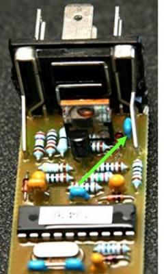

On page 1, someone very kindly put up photos of the thing to cut. Could someone tell me though, am i basically just cutting a length of the silver bit of that red bit?
As you will be able to tell from my description, electronics are not my thing! Is it just a case of getting some thin wire cutters perhaps and snipping out a bit so the red bit is no longer complete?
Basically, yes - the only thing I did was to 'completely' remove the diode (the 'red' bit) so there was no risk of anything shorting accross the remaining legs of the diode - you could either tape it up - or take a bit of time and care and remove the back leg so there's nothing left of the diode.

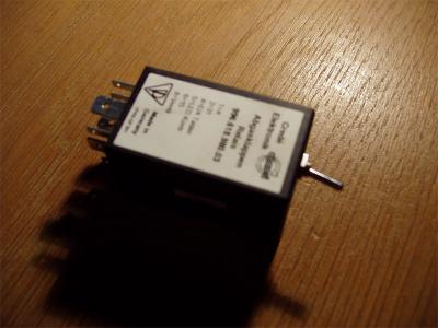

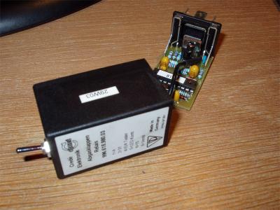

I have the relay on my desk in front of me.
How on earth do i get the cover off? Do you have to be quite aggresive? Im worried of breaking something at the moment.
Is it a case of making a gap on the edges with 2 screwdrivers, and then somehow pulling the relay out?
Finally managed to get it open - all done and soudnds great - thanks!

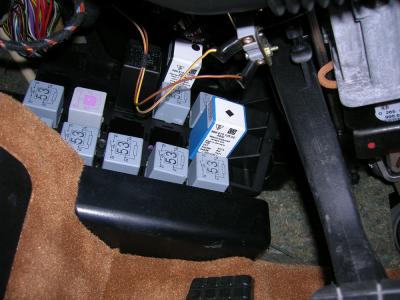

when i look under the driver's side, this is what i see.post-24562-1214202745_thumb.jpg
none of these relays appear to have the proper number. is there possibly another location? thanks!

Double check the black relay part number.
Share this post
"Also, in terms of actually getting to these relays - is it a get on your back and shimmy under the dash job? Is there any carpeting covering the wiring that I would need to remove first?"
"Yes - stick your head under the driver's side dash - nothing to remove as the relays should be exposed."
the black relay is part no. 1 397 328 015
