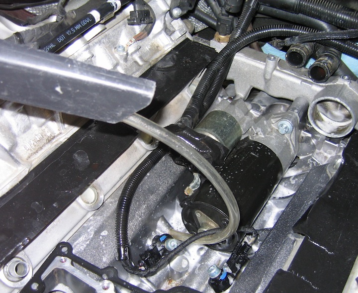

I have a Macgyver solution for removing coolant ect from the small crevices of the engine, only wish I had thought of this before I started the tube replacement. Of course one of these days I'm going to buy a fluid extractor......
Using a wet/dry vac insert a 2' piece of clear vinyl tubing (apx 3/8" dia) into the crevice tool of the vacuum cleaner (my tubing stayed held in the crevice tool just fine), DO NOT TAPE or otherwise close the rest of the opening, there's plenty of suction going through the tube. Use the other end of the tube to vacuum up the coolant. It can also be used to extract coolant from the other openings in the engine. It worked superbly for me, only wish I had figured it out earlier. I have a photo I'll post later.

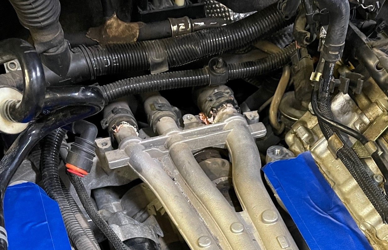

OK, guys, so I've been chasing a coolant leak on the back side of the engine on my 2004 Turbo.  I bought this thing about a year ago with 82k miles.  I knew the car had the metal pipes already so I suspected the plastic tees were the culprit.  I snooped around with a scope but couldn't really tell where the leak was coming from.
I finally bit the bullet and tore the intake manifold off and pressured the system up and located the leak - around the forward clamp on the rubber adapter hose on the main distribution pipe.  The hose definitely looks swelled up so I'm assuming the clamps dug in and cut a hole it the hose or something.  I ordered that hose & clamps obviously.  I'm going to replace the plastic tees while I'm in this deep, as well as the thermostat.
My question is has anyone ever heard of the adapter, hose, or metal distribution pipe going bad?  Obviously now would be the time to change them (and I know when I pry the hose out I'll see if there are any visible issues).  Just hoping someone might have some words of wisdom.
Also changing the valve cover gaskets while I'm here too.
Looks like two leaks to me. I would remove both and lean the aluminum end and the hose - then replace the clamps with screw type clamps
That is what I would do.
Obviously the heater lines are weeping, and I'll definately do as you've suggested.  However the main drip/stream I've identified is from one of the clamps circled in red.  Just wondering if you've ever heard that hose adapter going bad.  I can't get to either hose clamp to tighten it either...
I bought a new one (with new clamps) so it's going to get changed in any case.
There were some kits sold back when this was endemic that were made up by a vendor, who didn't use all Porsche parts - and that coupling was known to leak. I forget what company it was...  but that's a known leak spot with the aftermarket kit.  I believe it will require R&R of the upper pipes to fix.  I vaguely seem to recall some people unbolting and lifting the cover for the thermostat housing (where the 3 pipes go into the front of the engine) up to replace that coupling, that avoids having to pull the 3 pipe assembly out of the housing cover and replacing those O rings sealing it in.  Since you have to replace at least the clamps on the rear rubber pipes to the aluminum, your situation may be different.
