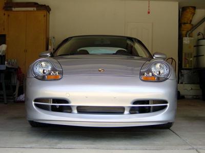

Got the center radiator on Ebay for $100 plus $20 for shipping and then got all the rest of the parts from the sponsor of this web site...for $232.
So for $352 i have all that's needed for the conversion. Oh maybe another $10 for a screen and trim. My bumper doesn't have the cutout.
Share this post
I'd like to see pics of your install when done. For those that have done the 3rd rad, do they catch a lot of crud, being so low and exposed there?
