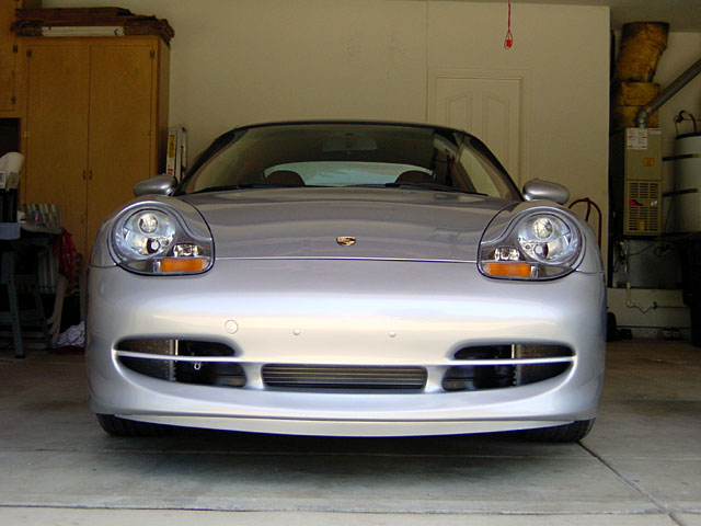

Just finished. Took me all day. Wanted to make sure that i cleaned the radiators really well. I cut the hole for the center radiator 4"x18". Seemed to work out.

It looks good but I don't think the rubber ducting around the center radiator is right.
It looks like it is drooping down in the top center?
I think your right. I am going to remove the front bumper again anyway. Seems i replace the passenger hose on the top, not the bottom. Dumb me.
The ducting can only fit one way right? I will go in and look at it again. Maybe i didn't get the tabs in all the way.

Got home and looked into the problem. I thought i put the hose on the top (Passenger Side) but didn't. I installed both of them correctly. The problem was with the fitting on the drivers side. For whatever reason the new hose is larger than the one that came off. So i had a leak from there. Don't have a clue why the sizes are different. Did i order the wrong part? Did i get a GT3 hose that would be larger?
