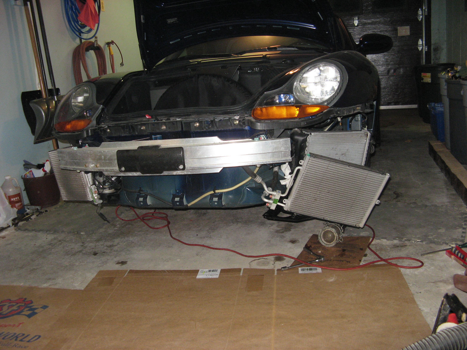

ok guys, so finally i got the bumper off. i know it didn't take long but just got a lot of sh*t going on. but anyway this is what is underneath. i guess i hit the center part of the radiator so it is causing it to leak on the left lower corner. see pic.
so let me know what is the next step? replace the entire radiator and what else? :help:

Shihman:
The radiator probably has to be replaced, although if the bend is not too bad and all you have is the leak, in some instances a radiator shop can re-solder the radiator or epoxy it and stop the leak.
You might be better off getting a used radiator from someone parting out their car if you don't want to spring for a new one. Take a look at the 986forum.com classifieds. There are a couple of guys parting out their 986's. You might get lucky.
One caution. Before you remove your radiator, get a couple of hose shutoff pliers and clamp the two radiator hoses shut. If you don't you're going to lose a lot of coolant and it will be that much harder to "burp" or bleed the cooling system after everything is back together. Pep Boys and Autozone sell a set of two pliers, made of red plastic that should do the job fine.

Shihman, the radiator in front of the leaking radiator is the air con condensor, You can seperate this from the water radiator without disconecting the air con fluid pipes (or you will need to regass the air con)
Just have a look at the hoses to see if anything else needs to be replaced - I would doubt it as the hoses seem to last forever.
I agree with Maurice - get the radiator repaired rather than replaced - a radiator repair shop will tell you if the radiator is past its sell by date and unrepairable.
Once you have changed it out and topped up the water dont forget to open the bleed valve just below the oil and water filler caps (take out the plastic false floor to reveal)
Start the engine with the water cap off and let the engine idle - the bleed valve will buble as the engine gets to opperating temperature and the thermostat opens as this flow of water will push the trapped air around the system.
Let it run for 5 or ten minutes after reaching operating temperature just to make sure all the trapped air is out then shut the valve --- Job Done.
