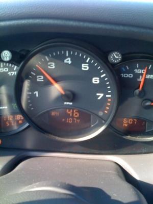

Hey,
i was out in my 99 boxster today...when i noticed the temp guage was between the 250 mark and the unmarked one before 250. it's around 115 degree's in the sun (105 in the shade), a/c full blast. i shut off the a/c and turned the heat on high and it went down the the unmarked spot a bit right of the middle, in about 40 seconds, then i had to turn the a/c back on (was simply to hot), finished my drive home, and it stayed just a bit above that unmarked line.
should i be worrying? oil is clean, coolant is full..

well i checked the coolant level, checked that the fans were kicking on with the a/c and they are. i took it for a 20 mile drive this evening, ambient temp of 100 outside, i ran it for about 13 miles with a/c set at 64, and the temp was between the 8 and 0 in 180, it started to go up a little to the middle of the 0 (and seemed to level off there) after about 13 miles, then i turned the a/c off, but left the blower going, but NOT heat, left it set at 64, a/c off, and it cooled back to between the 8 and 0.
i think it just needs a basic servicing.
