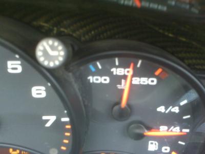

After days of driving, I have found that the water temperature is about 10-20 F higher in city driving than highway. Is that normal?
The picture below is the city driving reading. Highway reading is just above 180F.
Targeted coolant temp is 194F and on cool days at highway speeds, you can maintain this temperature close enough. Turning the AC on will increase temperatures, partially offset by fan operation. Around town, coolant temps can reach as high as 220F+. Sunny days add to temps. Based on your gauge, your temp is around 215F. You will see 180F only twice during a drive cycle. Once while you pass by it as the engine warms up and once when you pass by it after engine shut down.

Not to be argumentative, but I'd say his indicated temperature in the above pic is much closer to 202F, than 215F, which is also a considerably more normal temperature. Most every gauge that is non-linear, like the one shown, puts non labeled hashes at 50% of the difference between labels. Obviously, these are not any type of precision indication, and on my '02, I can't do the climate control hack, but I'd put the first unmarked hash at 140F and the second one at 215F. I know when I hooked up my Autoenginuity laptop to the OBD port and monitored temps, when mine was just at the right edge of the zero in 180, like his, or a bit more, I was at 203F. To get there I had to have AC off, and drive in 3rd on the interstate at about 70mph. Otherwise, during normal driving and commuting, I never see that gauge move off directly between the eight and zero, or 195F.
My 99' C2 runs at nearly he same temps as you describe, maybe just a tick lower. Normal summer highway driving indication is right between the 8 and the 0 and varies slightly based on outside air temps. In town it bumps 10-15 degrees and varies slightly running around the left edge to middle of the 0. Car has spotless radiators now, flushed and tight coolant system.
There's two things I find I'm always looking at and that's the Tempature & Oil,
(I'm obbsessed with this since a new engine install a while back)
This tempature reading in the picture looks normal for city driving.
But I'd say once your speed reached say about 60/70 mph it should settle down to around the 180 point? (increse a bit if AC is on)
I find when doing slow movement driving of any sort (traffic) the 911's tempature is never happy.
On my 996's last major service I added to the coolant tank RedLine Water Wetter you can mix this with the porsche coolant,
it help's to eliminate hot spot's forming in the engine maybe it's just my imagination but I find it really help's to keep the motor running cool.
When I'm doing between say 60/100 mph the tempature is perfectly on 180 even a little behind the number 8 and the oil is right up at mark 5
then say at 40/50 mph the oil is at 4 mark and the tempature is still at 180. (of course this all increse's to about 190 if the AC is on)
When in slow stop/start traffic the tempature is well over 180 and oil is inbetween 1 & 2 or just above 1. (not nice to be in)
I guess the more speed the more cool fresh air is been sucked in. This and a nice clean coolant tank, clean radiators & fresh coolant + water wetter
all make the differance to keeping the tempature down.

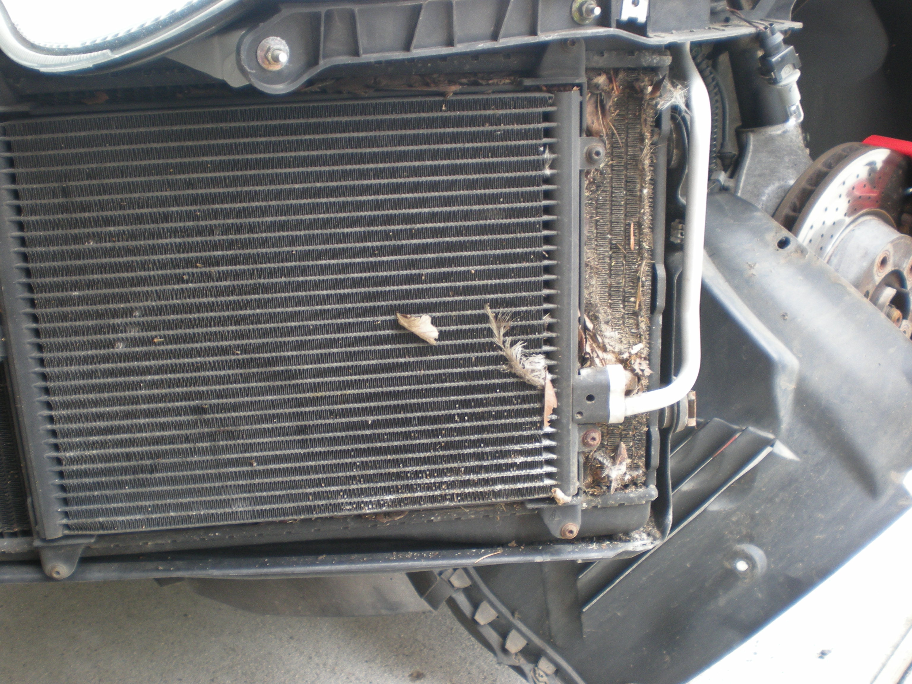

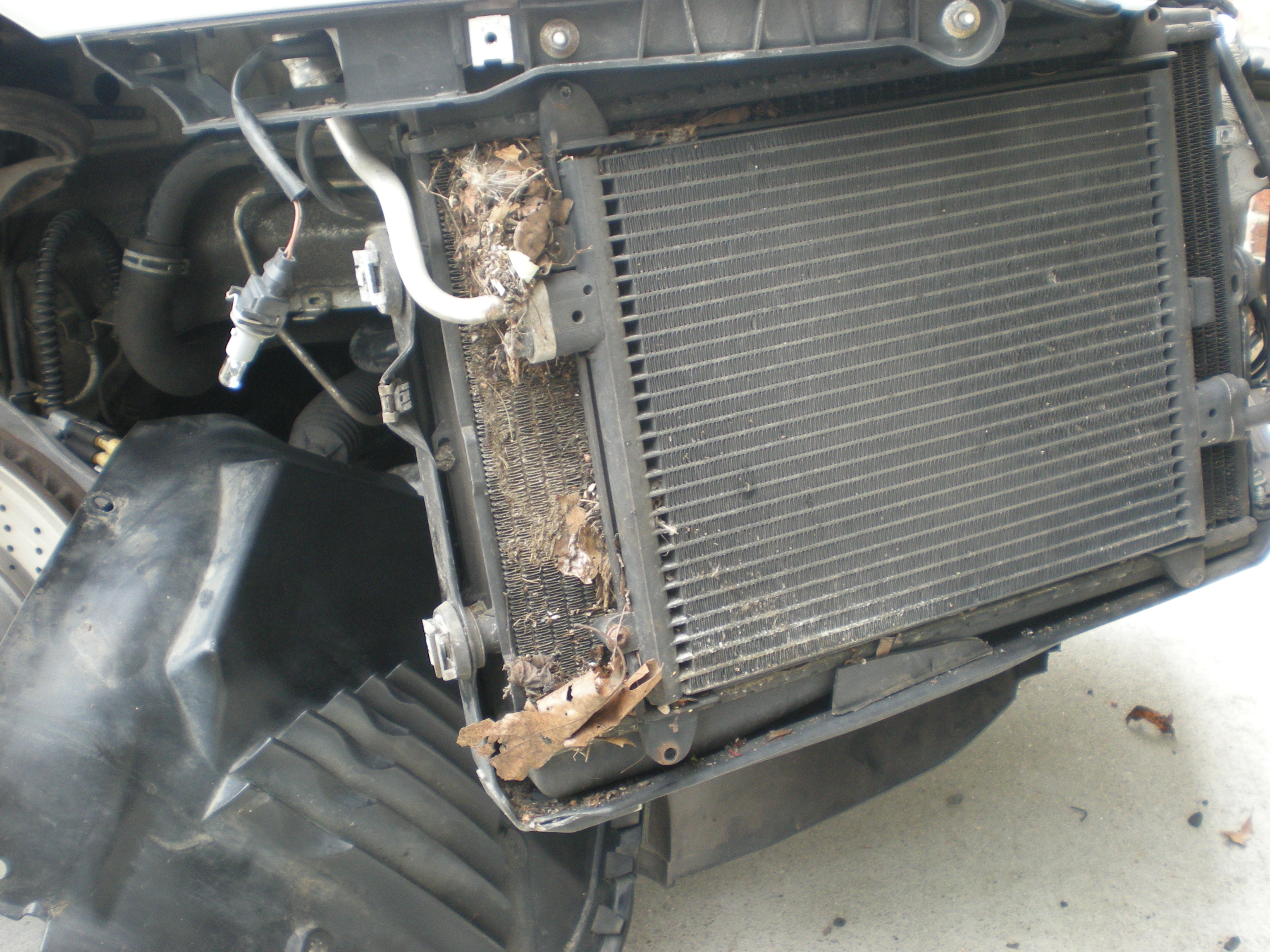

This has been covered here before but thought I would share the pics of my recent radiator cleaning. I sprayed the coils down with an aluminum clearner and was amazed at the grime flushed out... Made a definite difference in my 02 C4S.

Porsche 1999 C4 996 over heating concern; initially reported on August 21, 2009
After having the engine replaced, I noticed the engine compartment cooling fan would come on after shutting the motor down, even when the ambient temperatures were in the 50's F. In hot weather with temps over 90 F or so, the over temp light would flash. At the time we were in Nevada in July and just had to wait until sundown to drive any distance. We took it into a dealer in Reno who said that other than some grasshoppers, the radiators looked clean. And of course, we ran with the A/C turned off. The car, a 1999 996 C4 sat in the barn over winter and saw little road time. Now as spring has returned, so has the flashing overtemp light, again with outside temps only in the 60's.
So following the advice given last year; I pulled the bumper cover and cleaned out the radiators. Not surprisingly both were covered with debris over 30 percent of the frontal area. The debris was leaves, bugs, and a stiff coating of dust with the majority of it on the engine radiator, not on the A/C heat exchanger. The borescope could not see the area where all the junk was. Interesting how the dirt got packed into the space between the two. Cleaning was done with a vacuum and soft bristle brush; perhaps I should have pressure washed the radiators, but was not able to do so inside the garage. Next time I'll do the tear down outside and do a better job.
Problem solved? The overtemp light has not flashed after driving in stop and go traffic. However, the fan still comes on after shutdown. The dashboard gage quickly climbs to "180" with the needle right between 8 and 0 (and it is still no warmer outside that the mid 60F's). So far it has not gone above the indicated "180" under varying driving conditions. The fan typically runs 2 to 3 minutes after shutting the engine down, and then turns off.
