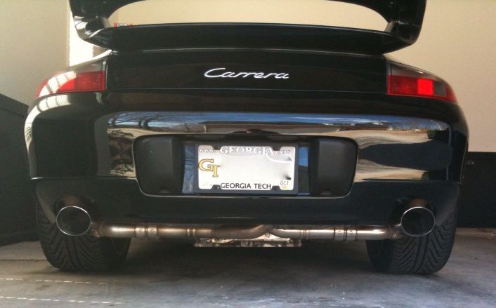

I tried a number of things over the last 6-8 weeks or so... Everything was done lying on the ground behind my car with the pipes in place :-)
PART 1:
  1. After a good wash... I spent a few hours with some steel wool #1, #0 and #00 and brasso (from Home Depot) and did a pretty good job of getting the first layer of brown cleaned off. I applied this by hand while wearing some latex rubber gloves. That Brasso is pretty strong and stinks a bit.
  2. I then tried some 100 grit sand paper with a foam pad. This helped get things to a light brown or almond color.
  3. I rinsed things off with water and dried off with some old terry cloth towels.
This photo shows how far I got at this point.
The left side still has some light brown color.
The right side has been polished with steps below.
PART 2:
  1. I then ordered some things from Amazon.com and this is where things got noticeably better.
  2. The mushroom buff on my drill along with the different polishing compounds took the light brown to a silver color
  3. The semichrome polish and the buff then brought out more silver and a bit of mirror finish
  4. The stainless steel is not chrome so it is not as nice as the tips, but it doesn't look "dirty" anymore
If I were to start over, I think I would skip the steel wool by hand and go with the drill, buff and compounds.
There are still some areas I cannot get to easily that could use some work but I'm satisfied for now. Definitely learned some things about stainless steel.

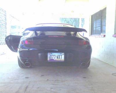

Bad camera pics but used the VHT (Flat Black) from checker. An observation is it looks much cleaner/almost disappear painted, but looses some of the grounding effect of stock cats. Put a few hundred on them and still look great no paint flaking etc.

You are right - it is a bit difficult to see with those shots but the results look good.
