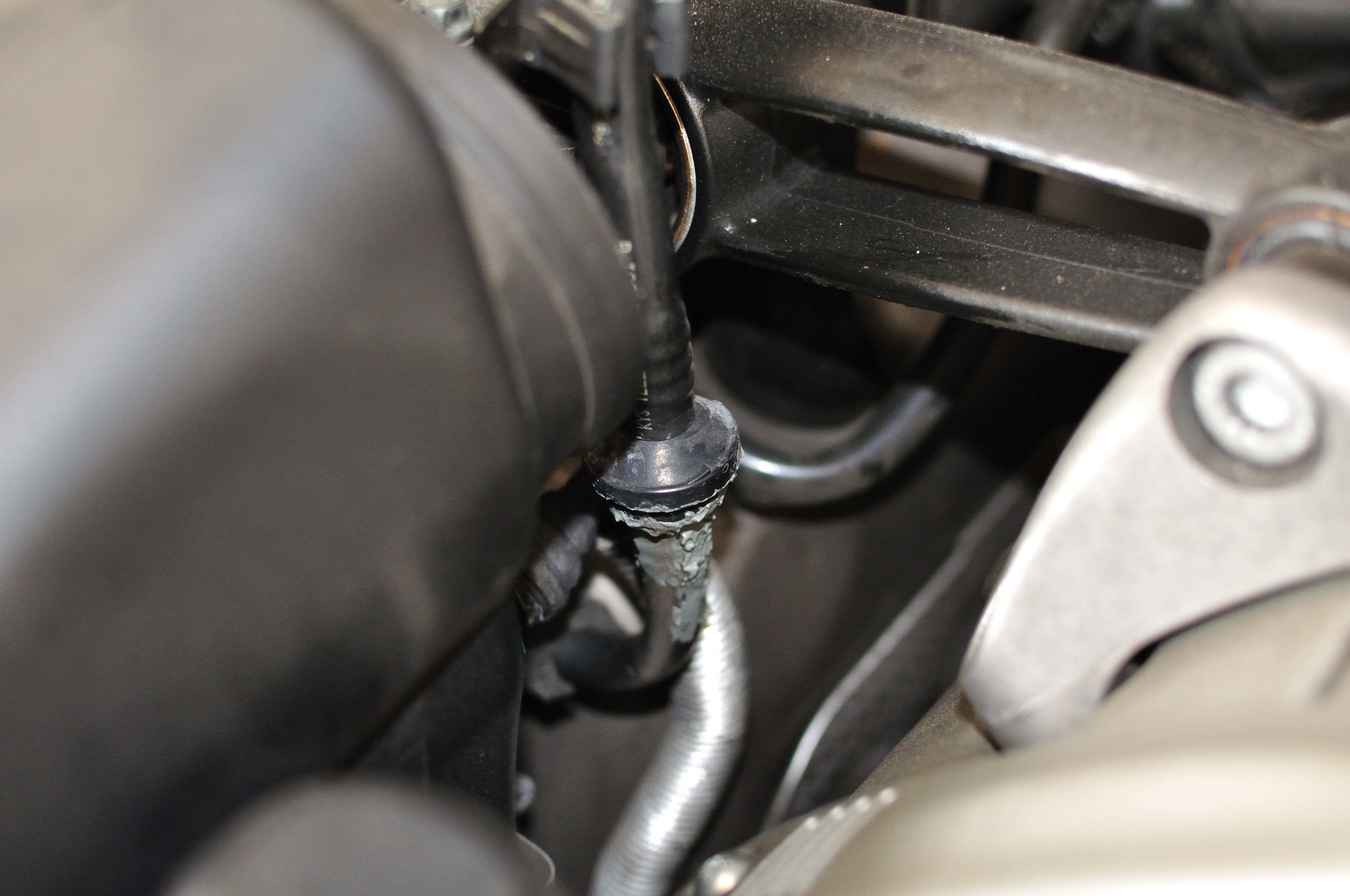

04 TT, same fault, "brake booster warning".
Same problem as TopGun2000. the hose/plastic pipe is cracked at the connection (bottom end). Most likely due to heat exposure. Wrapped electrical tape (for now), i guess 3/4" heatshrink will also do.
P/N is 7L5-611-931 G. Cleared code, seems ok.
it is under pass side engine cover (remove blue washer lid, remove torx screw at lid, loosen rubber gasket around, remove that "+" screw lock thingy, remove plastic cover, and it's right under the plastic cover.)
15 minute job total.

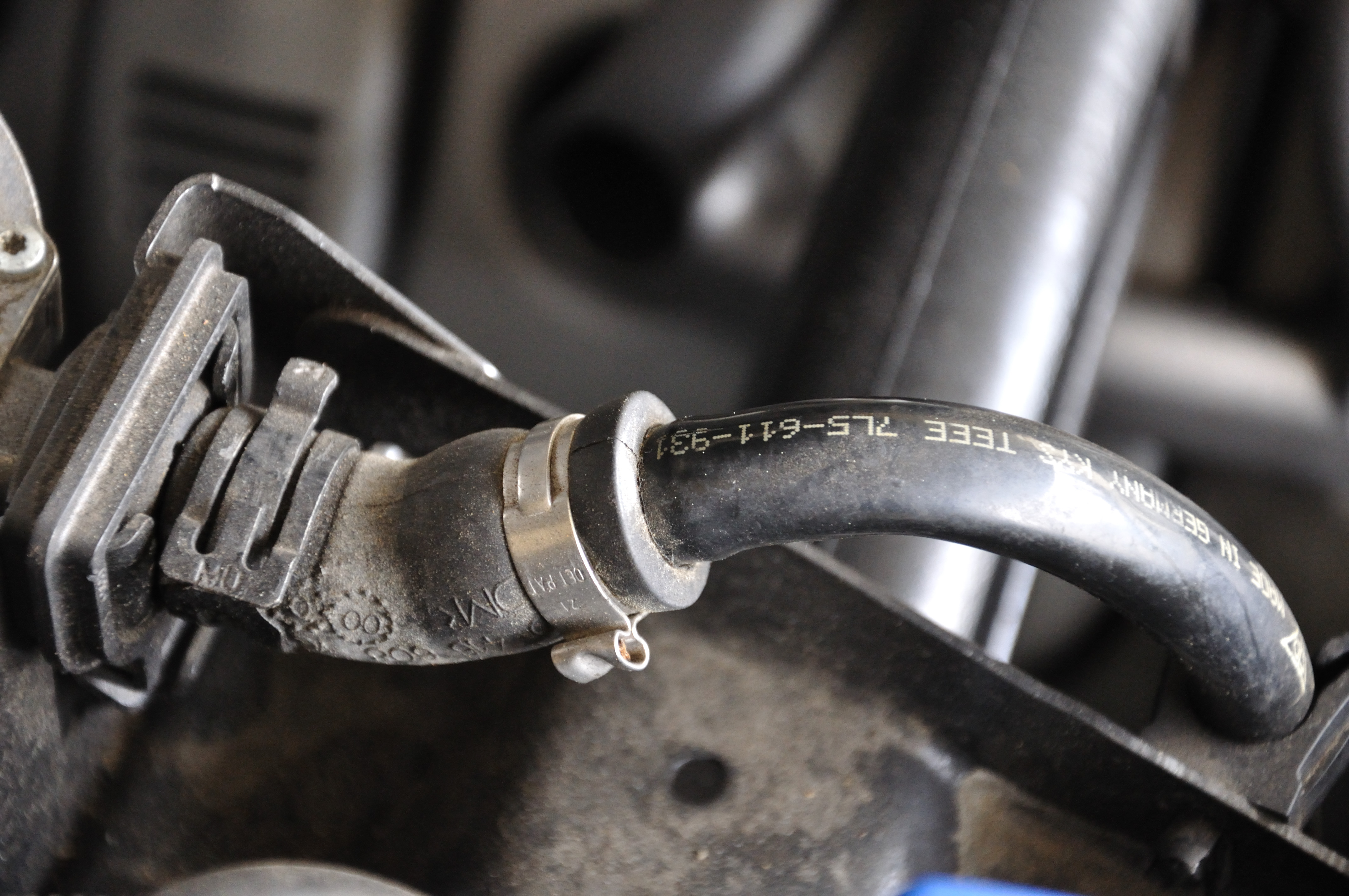

I found the problem: a cracked vacuum line (on the top of the hose at the "931" mark)!!! :cheers:
Obviously there was another old leak which was fixed by the previous owner in a JB Weld way. :jump:
:renntech:
The part number for the lower hose is 955-355-577-51 (thanks to Luke at Sunset). The other part number quoted by Spyrwebs is for the upper hose that number 931 is visible on the top.

I fixed mine by cutting off the broken hose below the one-way valve down to just above the 90o bend. I used some 1/2 inch vaccum hose to slip over the remaining pipe and bend.
Then I clamped it with a hose clamp, and clamped the other end to the bottom of the one way valve and re-inserted the one-way valve into the top part of the pipe.
Total cost about $10 and 30 minutes time, plus the new hose is so thick it'll never crack again.
Error message went after two starts and a bit of a drive.
