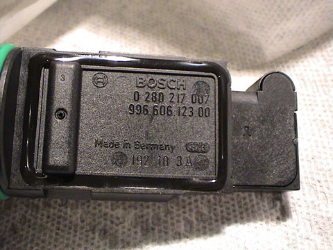

Here is a picture of my MAF.
How do I know which version I have?

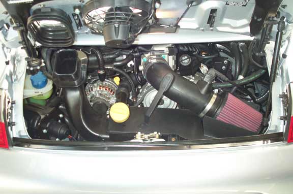

What is the AireTech Cold air pipe? Do you have a pic of the installation? Without knowing the setup, It appears that the MAF is calculating a larger volume of air therefore telling the computer to boost the amount of fuel being injected. The O2 sensors are then supposed to adjust the amount of fuel injected based on what they read. Apparently, the adjustment is too much.

The cold air pipe is shown below, lt really wakes the car's driving spirit. In order to fully explore this problem i need to see what voltage readings are on the O2, & MAF sensors, so i can compare voltages to other cars. The resister idea might be necessary if no real problems are found. No CEL yet on the trip to or from work today. Im off to go look at the CARCHIP/EX data recorder for OBD.

The only thing that is different with your new induction system is the replacement of the stock air chamber with a cone filter. What has this changed. Two things...less restriction on air flow into the intake and you have shortened the length the air flows before it is read by the MAF. Do you have a screen on the intake between the filter and MAF? This will help reduce air turbulance as it flows past the MAF.
Like I said, without a scan tool, the first thing I would do is reset the computer and reduce the airflow of the filter by covering part of it so air cannot flow through. I would cover like a third of the filter CLOSEST to the MAF by rapping it in cellophane. If this eliminates the CEL, then I would test it by removing the cellophane and installing a screen over the tube between the filter and the MAF and test again.
If blocking some of the filters flow fixes it, then the permanent fix is easy. Let me know how the test comes out.

I did one better I installed the Stock Airbox and reset the light, now No CEL. Im giong to drive it that way for a day or two before I decide to put the Air Pipe install back on. The Intake kit is great , it really gives the car better sound, and power, but at the expense of running around with the light CEL on.
But the question about the screen ,yesy there is a screen before the MAF filter on the Airetec airbox, I know it draws substantially more air than the stock unit.
