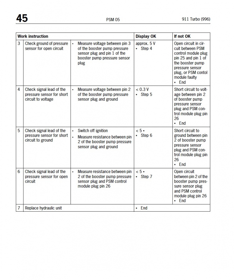

I've followed the troubleshooting guide for the pressure sensor connector and found pin 3 on the wiring harness connector, which should read 0v, shows 5v. This indicates a short some where in the wiring. My Porsche dealer said the ABS/ PSM hydraulic unit is bad although the fault is in the wiring harness. This seems inconsistent with the fault in the connector. Any thoughts on how to trouble shoot this further.
I need to correct this. At step 4 of the attached, I get 5v from pin 2. I need help with my next step.

Short circuit to voltage between pin 2 of booster pump pressure sensor plug and PSM control module plug pin 26 → End.
If you can not find a wiring connector issue then you will likely need to replace the hydraulic unit.
