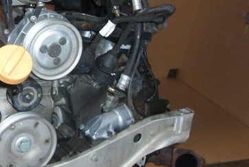

I agree with JFP. I happen to know for a fact the only thing that needs to be moved from the old engine (tiptronic) to the new is the water neck (see pic showing neck transferred to old engine for core return) on a factory reman. Seems like you are just getting a long block?? Didn't see this option available in the reman catalog
