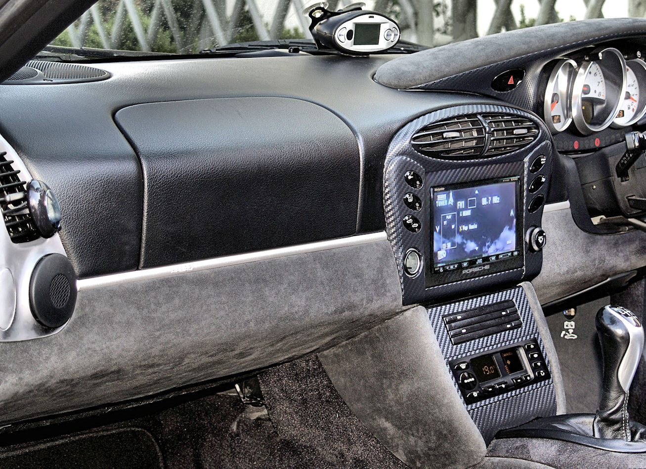

Well, here's the result to my Boxster S so far:
Re trimmed lower part of dash, instrument pod, side panels and knee panels in anthracite alcantara. Re-trimmed centre console in black alcantara. Sprayed and lacquered strips in 'Nissan silver'. Dash, upper and lower console carbon fibre and fitted a JVC KW-NX7000 using trieullionaires double din fitting kit (great kit btw!)
