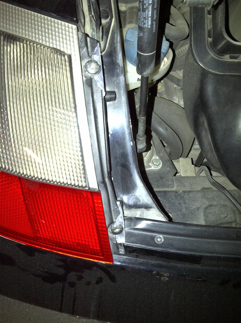

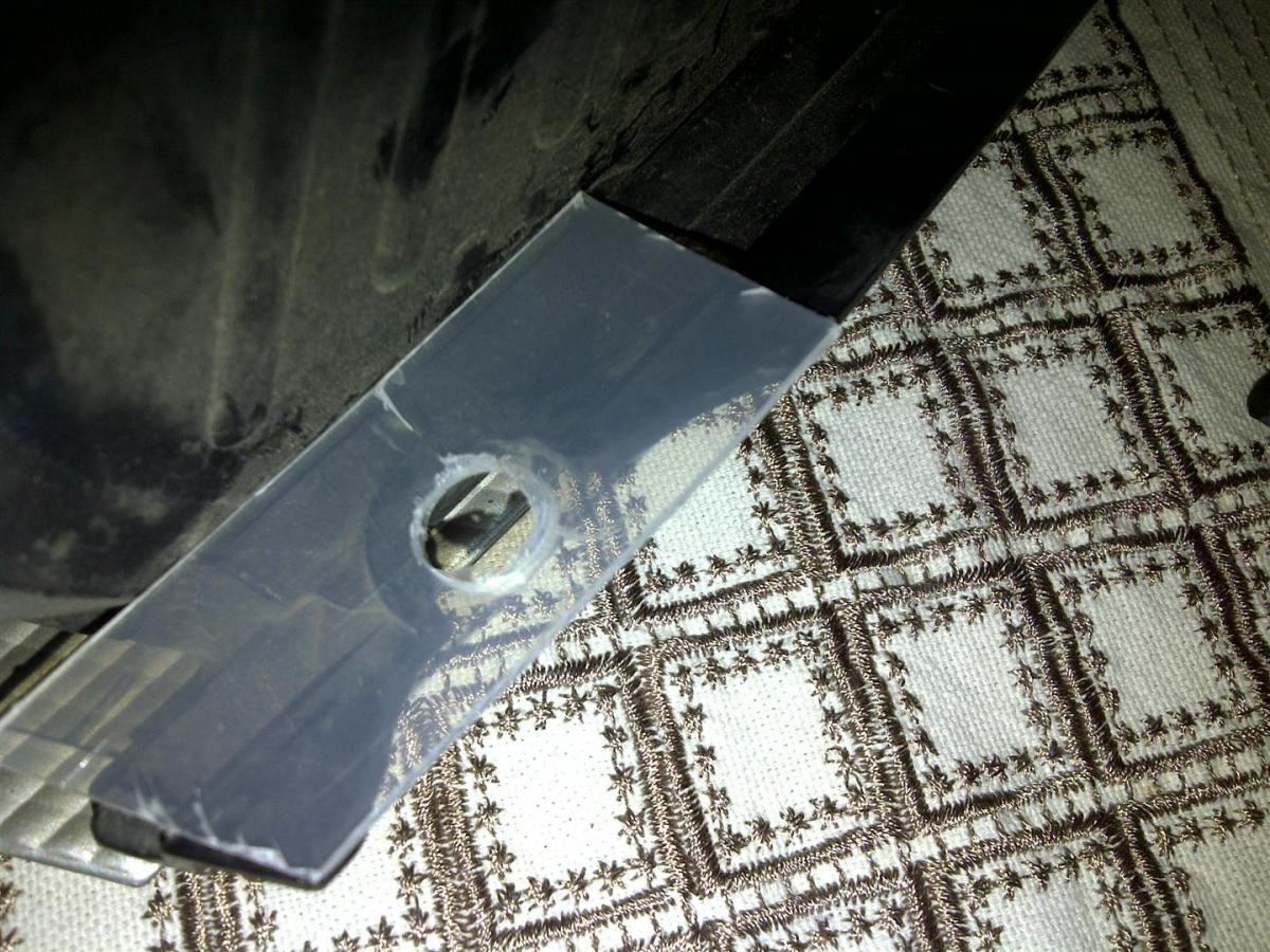

Well after checking lots of website online, decided to do the fix myself and not splash out on a pair of new tail lights.
Below are some pictures of how i fixed them, all it cost was a tupperware and silicon based glue to withstand the high temperatures here in the summer.

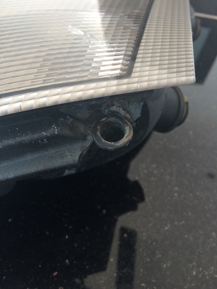

Sorry for the thread revival, but was looking for instructions on how to remove the rear tail lights on my car as some a$$ho!e decided he would either try and steal one of them, or sat on it and broke the two tabs that attach it to the car.  Luckily for me, found this post and will promptly do the same repair.  My car too is a C4S and it is the driver's side rear tail light that had the tabs broken by the aforementioned a$$ho!e who will not take claim for his/her action.
Any tips on which glue to use?  Another doubt.... After removing the two screws that are close to the engine lid, do I just pull on the assembly and it comes out, or is there a third screw holding it in place?  Mine seems to sit pretty well and tight even with the two tabs broken.

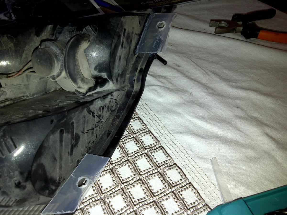

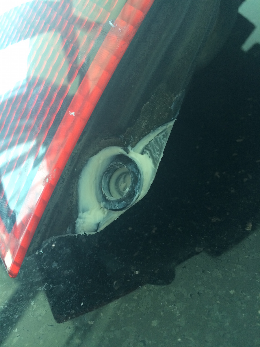

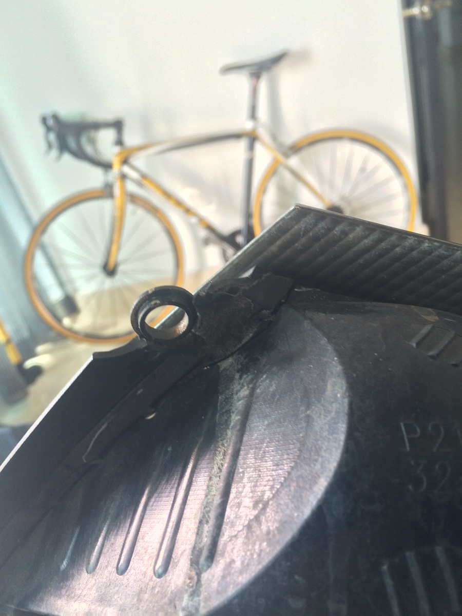

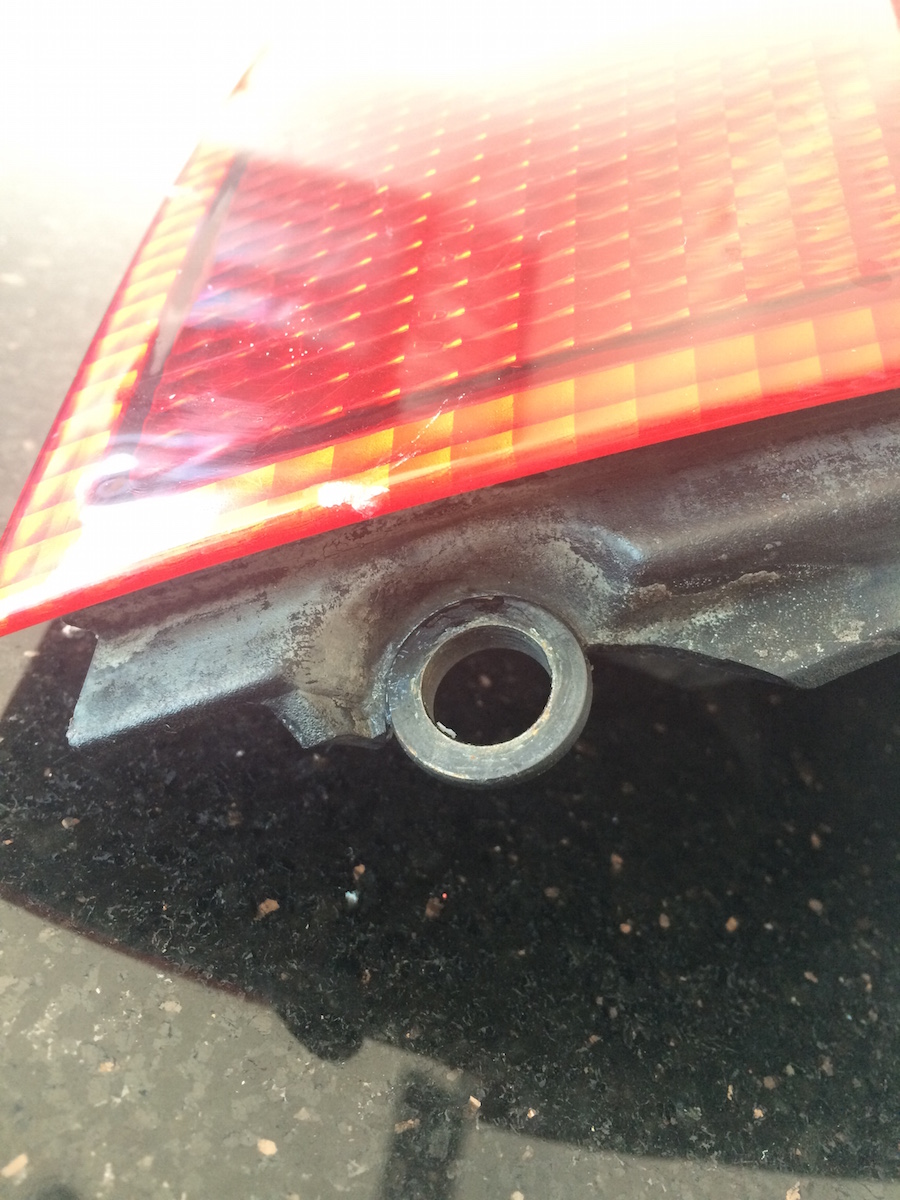

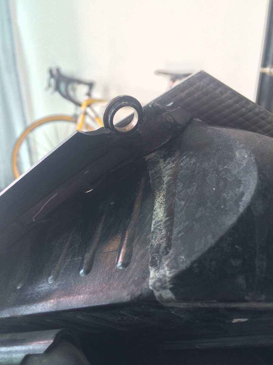

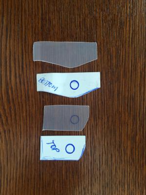

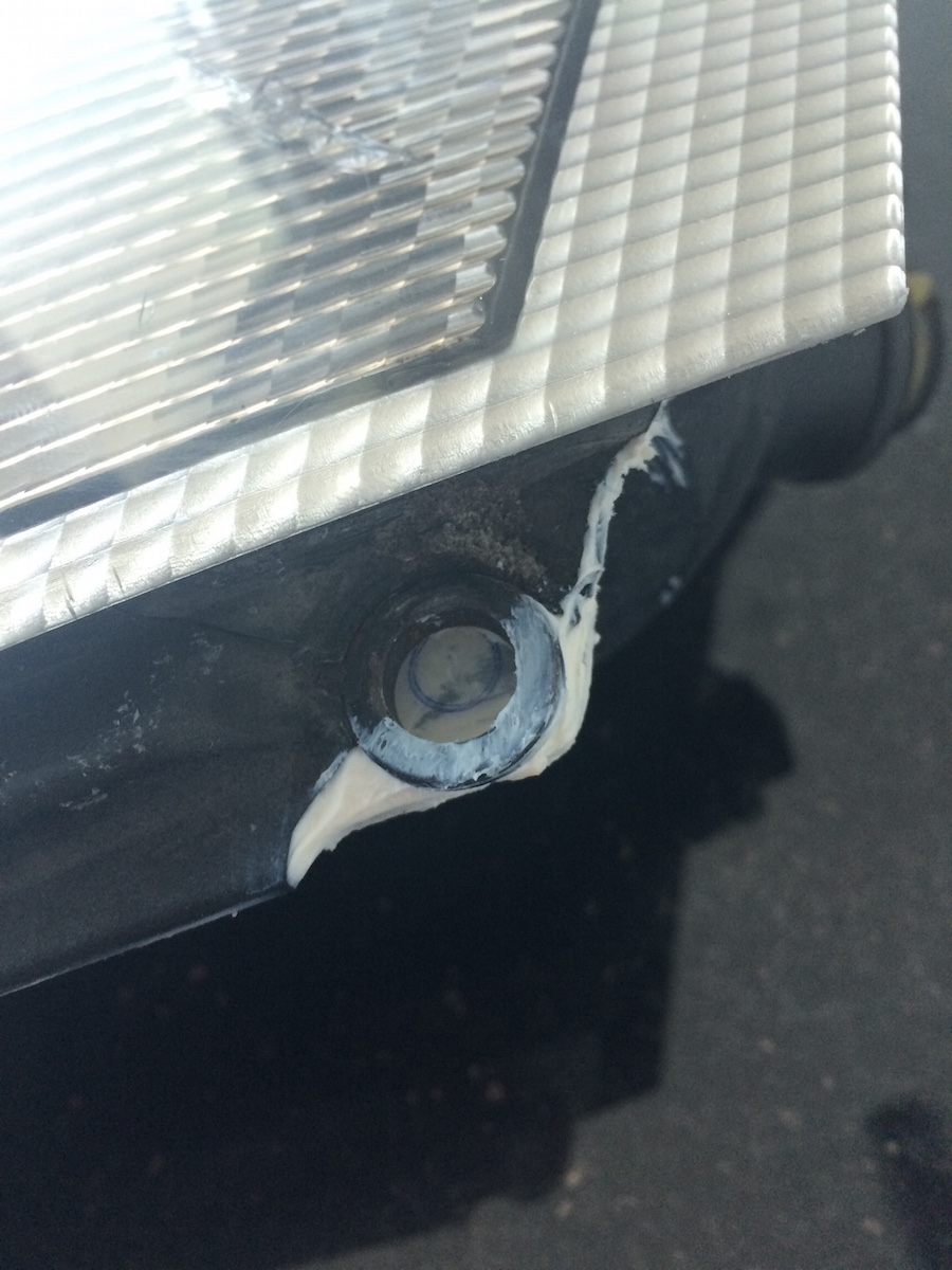

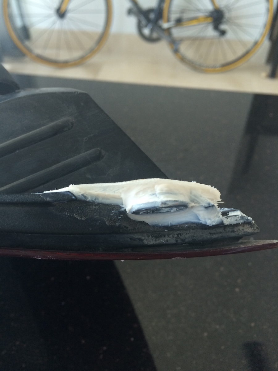

I finally got around fixing my tail light.  I believe a picture paints a thousand words, so here are a few of them that show what I did five months ago and still holding up.  May serve someone else in the future.

Nice going! I wonder if SUGRU might work as well for a job lilke this as you can form it to whatever shape like this and then wait for 24 hrs for it to firm up.
Here's one thought when you re-install the tail light bodies, I think often that the mounting bracket under the tail light is not adjusted to the angle of the tail light body.  Also the tendancy is to over tighten the Torx screws.  Just tighten until the light body is stabilzed, it's not going anywhere...  Also the tail light lens will crack, nearly looks like a factory line, but I think that is another reason why you can torque the tail light body by having the mounting bracket out of alignment and over tightening...
No question that the tail light housing mounting tabs are under engineered...  I can't begin to know how many plastic connections that I've broken working on the car. Porsche should do better on this...
