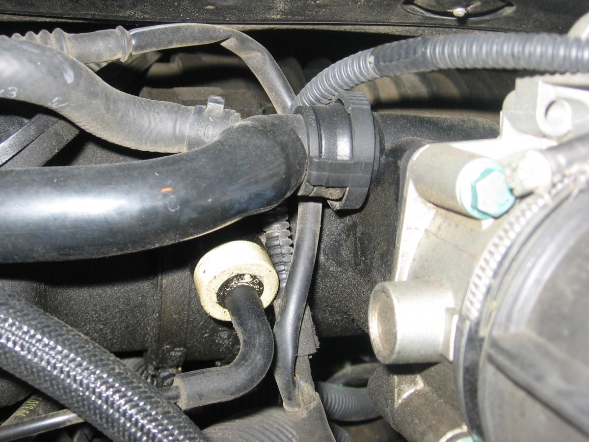

I've attached a picture of my 02-996-Cabby resonance intake tube "weeping" @ 64K miles. I have no fault code on my durametric reader and no smoke. I do consume a very minimal amount of oil, but I haven't yet kept track of the actual amount. Like others, I am suspecting the AOS is beginning to fail, and I am wondering if anyone knows an "actual value" on the durametric tool that might assist in this diagnosis, (perhaps something to do with airflow values?) I do understand the integrity tests for the AOS that have been posted herein, but in the absence of other symptoms, I'm not likely to do all that quite yet.

The Durametric is not going to provide definitive data indicating that the AOS is on the way out; you best bet is to try and remove the oil filler cap while idling. If the cap comes off with little effort, the AOS is fine; but if it takes a lot of force to remove it due to high case vacuum, the AOS is toast.
I checked the oil cap after a 1/2 hour drive this morning. It came off quite easily (as normal) but I felt a "very slight" suction, and I noticed a slight increase in engine idle RPM, but still very smooth idle. Does that tell me anything about the AOS?
Crankcase vacuum is normally far less than intake vacuum.
I suppose perhaps in the case of a gross intake leak, where vacuum is greatly reduced perhaps the AOS cant do it's job as well???
Sounds like you are fine. A normal AOS gives you a vacuum level of about 5 inches of water, basically the slight suction you felt. When they fail, the vacuum level jumps to several times that level, making the cap nearly impossible to get off.

Thanks, Logray. Yes, I've done what you did but less elegantly as your setup :) Mine is about 6in H2O so it's normal. My car always burns 1 quart / 1400 miles, even when new. Now it has about 54k miles. I just think that oil gets sucked into the intake from AOS, as opposed to seeping through the oil rings....just a theory.
