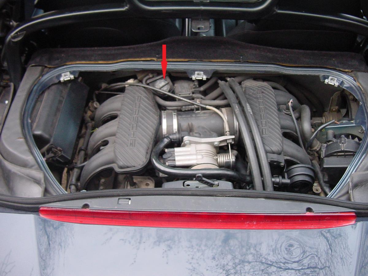

Just a quick one, where do I top up the power steering fluid on a 2005 Porsche Boxster? It makes a moaning noise when I turn the wheel slightly to the left or right. Thanks!

The power steering pump and reservoir is located at the very front of the engine compartment, on the driver's (left) side, just to the left of center.
Here is a photo of the reservoir and the cap, at the red arrow (Note that this photo is from an early 986, but the location is the same):
(click on the photo to enlarge)

Thank you! So I've got to get access to the engine....
That's easy enough. Take a look at your owner's manual. The 987 require a torx or other type of screwdriver to remove the engine cover. The 986's had "turnbuckle-type" fasteners that could be removed by hand. I guess Porsche wants us to pay more visits to their dealers for these complicated procedures! LOL!

Ok I'll have a look in there. Thanks alot for the replies mate! Does it matter what power steering fluid I use? Cheers.

The factory fluid is definitely a good idea. Pentosin, IIRC.
