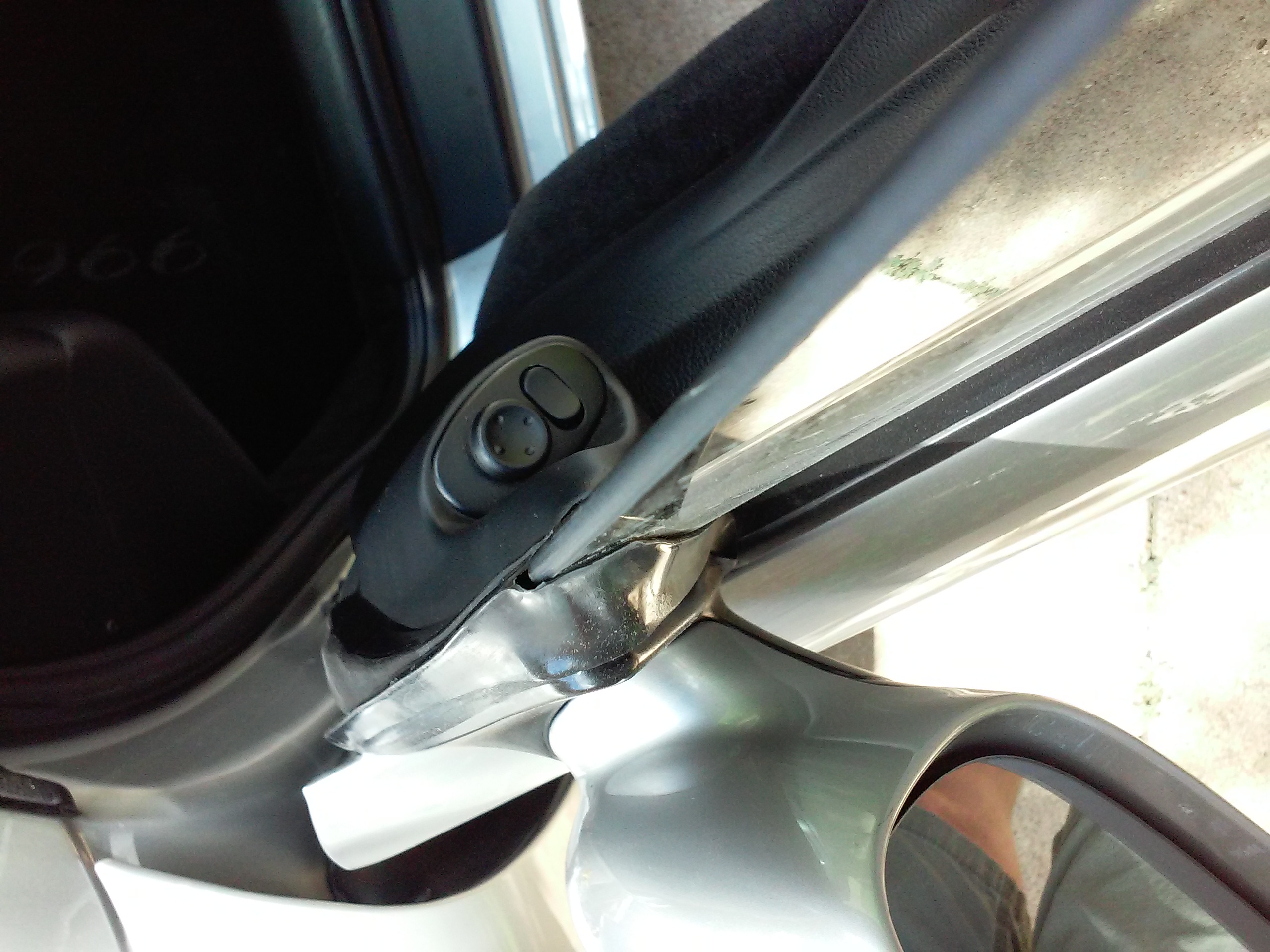

I have attached 2 photos showing my driver side door (opens/closes with no problem) and my passenger side door (sticks). As you can see from the photos, when the doors are closed....on my driver's side there is a much wider gap between the two pieces of glass as opposed to the passenger side door. I've come to the conclusion that the reason the passenger door is sticking is because this gap isn't big enough.. and this is verified in that I can see when opening the passenger door handle and the glass lowers it's hitting up against the backseat glass window. On the driver's side when the door is opened and the window lowers, there's still a decent size gap giving plenty of room for the door to open without hitting/sticking.
Is there a way to adjust the position of the glass window in the door? The door wasn't sticking previously so it appears that somehow the window got out of alignment

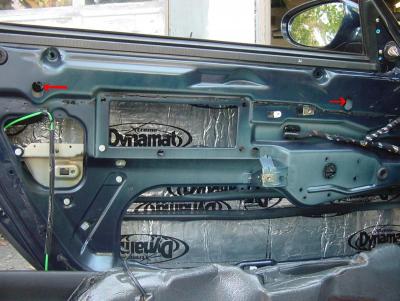

There are two bolts that hold the upper part of each of the two legs of the window regulator, and those two can be accessed by removing the door panel. Those must be where he made the adjustment. Here is a photo of the location of the access holes for the two bolts, indicated by the two red arrows, just above where the foam liner would be if it were glued on:
post-6627-0-60974800-1334861812_thumb.jp
By loosening the two bolts, you can shift the window further towards the front or further towards the back, but that adjustment also tilts the orientation of the legs of the window regulator. I guess it must have been sufficient in your case as perhaps those two bolts came loose and thus allowed the legs to shift at their upper ends. If the window goes out of alignment again, you would be wise to check that the window clamps are not the ones that got loose and allowed the window to shift out of position.

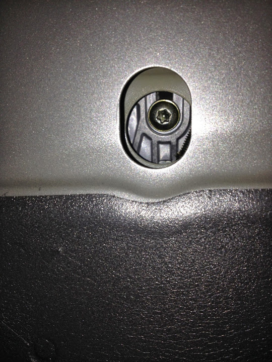

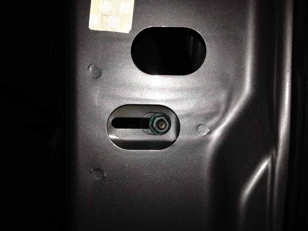

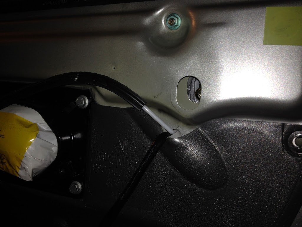

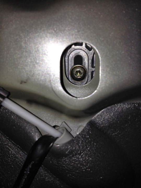

I just performed an adjustment on my 2002 996 where the rear of the window was touching the quarter window. I was successful, but along the way I learned more about how the window adjustments work. Some of this will slightly contradict information above.
MOST important, the adjustments found above the door inner cover are not the upper window rail attachments. They are the window glass CLAMPS as described above, and are only available when the window is fully raised:
Here are the bottom of door adjustments:
  • 1 year later...

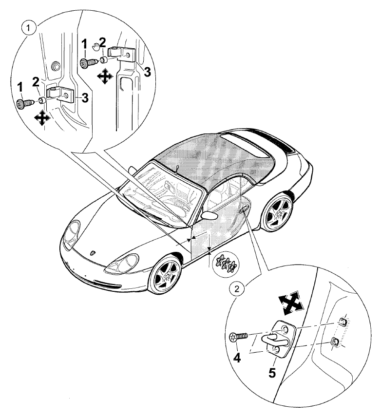

I am having the me window to window contact, but for my driver side door. It appears to be a door alignment issue instead of a window issue. The seam at the top of the door is a little lower than the top of the back panel and the door is harder to close than my passenger door. Any advise on how to get the door adjusted?
1 hour ago, Kdgiv said:
Awesome... Thank you. I will take a look...
After further investigation, the door alignment is fine. It looks more like alignment of the window. The top rear edge of the window is tighter than the bottom edge. I also noticed a gap at the front edge where the glass goes into the rubber channel. I am confused in what adjustment to make.
