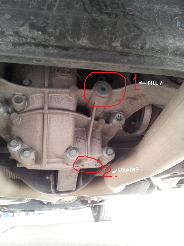

This is a pic from the rear of the car (looking towards the front).
Can you confirm that this is the rear differential, and #2 is the drain plug, and #1 is the fill plug
1 - fill plug
2 - drain plug
Want to confirm before doing the job. Thank you yet again.

Hi. I did that in the dying section. ~67k on Odo. Fluid looked almost black, looking closely had some greenish tinge. Appeared very thin in consistency (almost like water). Take a look at the write up that show pics - in dying section - maintenance section, named rear diff fluid change.
