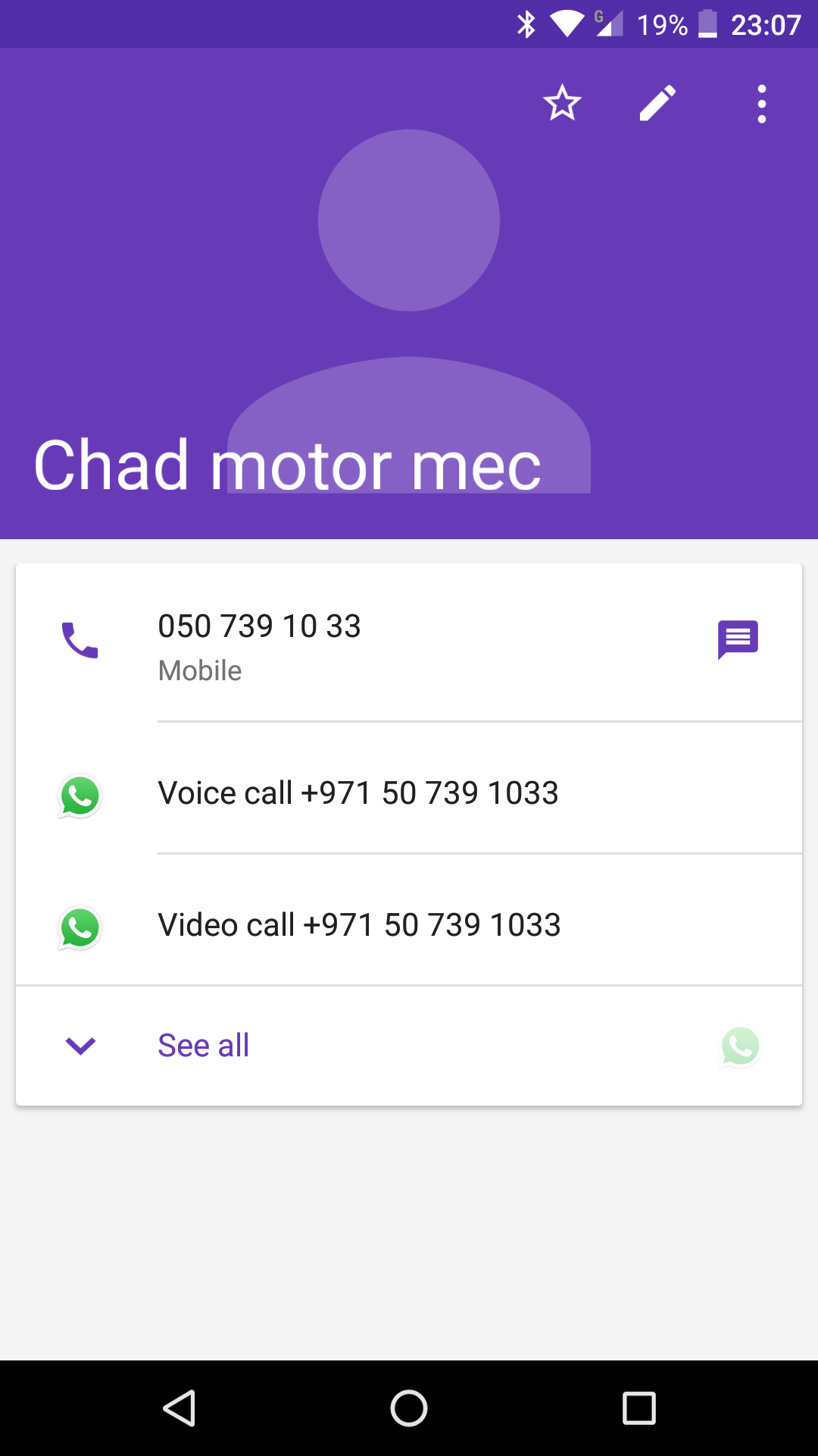

Go see Chad at Motor MEC in Al Quoz and get him to recode the steering angle sensor with his PIWIS tester.  Seems the 2004 model year is a pain in the *** for disconnecting battery issue after.
