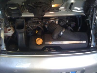

thanks, I found a 996 air box pretty reasonable (ok cheap) but that 997 does look much nicer, so I'm going to search around some more, btw, is the silver part where it says Porsche 3.8, metal? or just a coated plastic?

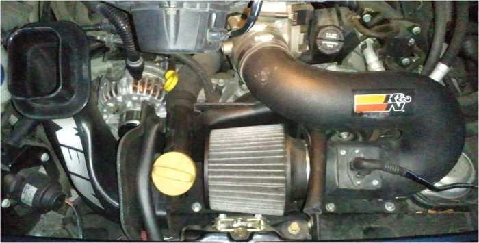

looking at ours again I see the air horn going to the trunk says AEM on it, the air tube to intake says K&N here is a pic of ours I took this AM

Yes KTS it's metal
thank you, still looking for a 997 air box, I would love to see one up close, and see how that metal strip is attached, , being the can;t leave well enough alone type, if I do go the 997 route, I would make a piece of stainless or aluminum that still says Prosche and omit the engine size, or put it correct for my (oops HER) car <g>
