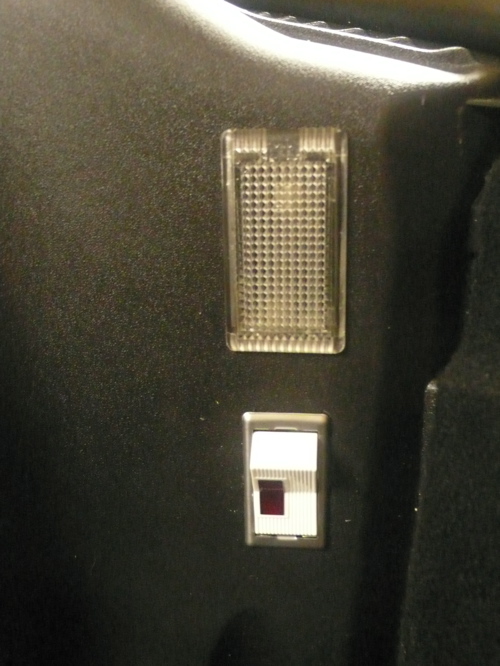

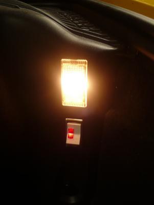

I still need to replace the micro switch at the trunk latch mechanism... Glenn at Pelican said he would order one for me. However I still wanted to control the trunk light, so I installed this lighted switch. Interesting enough the trunk light will turn off when the interior lights go off after closing the door. It's on the same circuit as the interior lights. FYI, C3 15A fuse protects the interior lights, the sun roof motor, and the trunk light. There's a couple of other accessories that I can't think of this minute that works off the same fuse.
