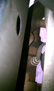

Anyway, so here's where my trouble starts (and correct me if I mix up the sensors or make other mistakes). I'm only doing the drivers side right now, and the only part(s) I've removed is the ram air duct. How am I supposed to get the sensors off? I'm using the tools in the picture attached. Is there something better I should be using? The precat sensor is much easier to get to and I can get my o2 sensor wrench around it...but there's just not enough room to attach my wrench into the socket and turn. The angle is awkward. The postcat sensor is REALLY tough to get at. It's really up in there -- on top of the catalytic converter drum -- and the engine is so crammed together there's just not a lot of gaps to get your tools up there. I wanted to be able to get at it from the top (engine compartment) because it's real close, but there's not enough room to get my hands in there. Assuming I'm supposed to get at both of these from the bottom of the car, I just don't see any openings where I can get the wrench in there at the right angle and turn. Even if I was able to somehow get the postcat sensor off, I don't know how I can get my hands in there to get the new sensor seated and screwed in before I would even think about tightening it up.
Advice on how to actually get these out from anyone that's done this would be greatly appreciated. Conceptually it's so simple and I can see everything. I just can't get my tools in there.

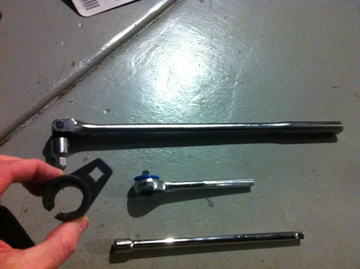

Yes, I am trying to get to them from underneath the car. Unless there are some other tools that would make this easier, I just don't see how to get my tools up there with the o2 wrench on it. Especially with the post-cat sensor that's on top of the catalytic converter drum. The pre-cat is much more accessible and I could probably figure that out eventually...although I was still having trouble with that too. I'm also doing this with the car jacked up -- no lift.
Looks like some folks faced the same problem and had to remove the cats but at least one managed to remove the sensors with a regular wrench without removing the cats. Check post #12 here http://forums.rennlist.com/rennforums/996-forum/514234-o2-sensor-removal.html
Will this tool help? http://www.tooltopia.com/calvan-tools-843.aspx?utm_source=pricegrabber&utm_medium=cse&utm_term=CAL843&utm_campaign=pricegrabber_r1
Hope JFP or someone else can chime in. Also don't forget to hit the sensor and any bolt you need to loosen with PB blaster or Kroil before removal.
Edited by Ahsai
Take a look from the top down after removing the intake air tube, if you are using the sensor wrench I like, you should be able to get 3/8 drive extensions down to it (place sensor wrench on the sensor from below, then work from above), perhaps with a "wobble" joint in the middle depending upon the length of your extensions.

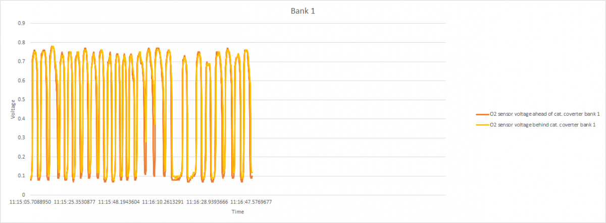

Anyway, it looks like my cats are bad (especially Bank 1). See attached.
Questions from here:
1. What should I do? Bank 1 readings, if I understand correctly look BAD. Bank 2 looks like it's half working.
2. Assuming I need new cats, I guess it's not worth asking Porsche since I understand the warranty is 8yrs/80K miles and I have a 2002 with 102K miles. Would you guys recommend going again for the OEM cats or someone like Fabspeed? Or someone else?
3. Should I be looking at anything further upstream that could be cause for concern?
4. How much are my old/broken cats worth at a junk yard?
The strange thing is, you wouldn't know there's a problem with the car driving it. Seemingly no loss of power or anything else that might be alarming. I have read some other posts though that said there might have been a problem with the 2002's cats, etc. I have seen other posts with similar issues. Take a look at some of these if you are interested:
The strange thing is, you wouldn't know there's a problem with the car driving it. Seemingly no loss of power or anything else that might be alarming. I have read some other posts though that said there might have been a problem with the 2002's cats, etc. I have seen other posts with similar issues. Take a look at some of these is you are interested:

Yeah, bank 1 is not looking good, and bank 2 does not look far behind.
Porsche will not be of any help as you are way past the warranty points. But it never hurts to ask, you may catch them on a good day………
Cats die from vibration, age, and mileage unless fouled out by something like engine oil. I doubt anything upstream is an issue.
You may be shocked to find that most dealers now impose a "core charge" for old cats, not unlike alternators or starters. Even dead, the rare metal inside the cat is recoverable and quite valuable.
I'm sure the pros are much better.
Perhaps; but as Warren Buffet once commented, “It is real easy to look like you can walk on water when you know where all the rocks are; but it takes years of getting wet to find them all.”
Quite often, when working in very confined spaces like this project, something as dumb as the position you hold your hand in while inserting it in there makes all the difference in the world.
What JFP said. Also, it's not strang because your front sensors are working correctly, there's no performance difference. The only diff is you are emitting less clean combusted gas.
That's true. I guess I just meant I find it strange I have no symptoms. If the cats were clogged (oil, etc) then I would expect to get low pressure through those cats. If the honeycomb inside the cat was broken from vibration, I understand that you can hear it in there when you tap on the cat with a rubber mallet. I don't get either of these symptons. Maybe it's just possible that the precious metals in the cats have just reached their lives in terms of their ability to catalyze at 100K miles. However, this doesn't seem to trigger the CEL very aggressively as I've only gotten the P0420 and P0430 one time (both at once), despite the fact that you can see there's an issue with the post-cat voltages, and I drive the car every day.

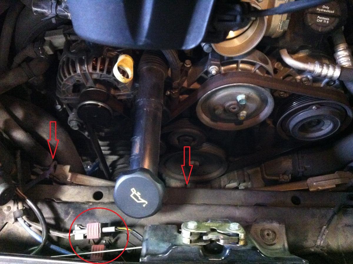

Back to the o2 sensors, I took some images during replacement of the o2 sensors. The two images below are of the engine compartment on both drivers side (left) and passenger side (right). All that I have taken out is 1. the air duct (it snaps right off, two clips on the sides and one on the bottom) and 2. the filter housing box (also very easy, just a few screws and pulls out). As mentioned earlier, I used a open-faced wrench (22mm) because it is "thin" and there's not a lot of room to work.
The two pre-cats can be accessed from the bottom of the car. The post-cats are on top of the cat's drum and can be accessed from the top, as shown in the pictures below. I have circled the location of the sensors in red, and placed arrows indicating where the wires lead to and where you can get your hands in with a wrench. Those red clips on top of where the sensors plug into the DME/ECU can be popped up with a screwdriver.
