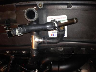

It may be worth while looking at upgrading the plastic t piece with a metal substitute.
I've read about people sourcing metal tees that will fit the hoses.
Will give a more "permanent" repair if anything.

Definitely off to the plumbing store to source brass T.
The front one wvicary is talking about looks like crankcase ventilation. Ill look at that too.

If you are talking about the coolant T behind/below firewall leading to the turbos, I was able to blind reach from top, basically lay on top of engine and stick my arm in there. From bottom, you can pick and poke the with a stick but can't grasp it. Besides, you need to further push up to remove them.
The hose that feeds driver side turbo is reachable from bottom.
You need to get a cable operated hose clamp opener. I got craftsman tool, but it opens barely not enough to loosen the clamp, get a better one.
When you remove the T, actually 2 T's connected making an H, observe the hose and T orientation and pre assemble the new units identically. And don't forget to pre install the bands (!)
