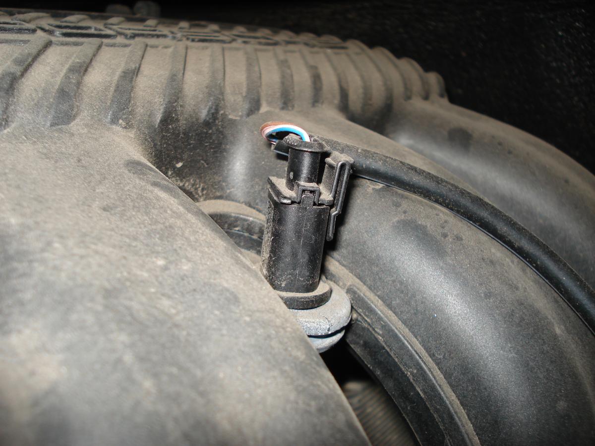

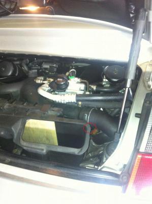

It's here (circled in red) in the Turbo. I included two pics, one is zoomed out to show where in the engine compartment... the second is showing specifically what it looks like.
p.s. Sorry, noticed this is in the Carrera (non-Turbo) section of the site after I posted this (I was dealing with something related on a Turbo for the last week)...but this could still be informative for someone in the future nonetheless. Thanks

how do I replace mine?
is it screwed in?
If you are referring to the sensor, it is simply inserted into the rubber/plastic holder which is then pushed onto the ridges of the intake runners. No fasteners involved.
