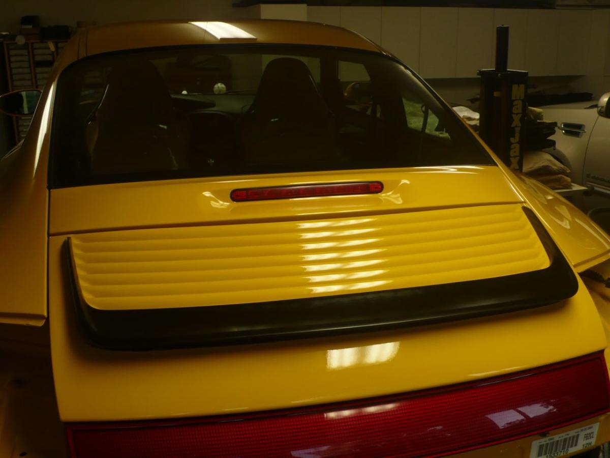

Personally while the spoiler has a definite function, I never thought it was attractive look when it is in the raised position, it spoils the nice lines of the car... I had other reasons for removing it. I blended the grill to the deck lid and added the small spoiler.
