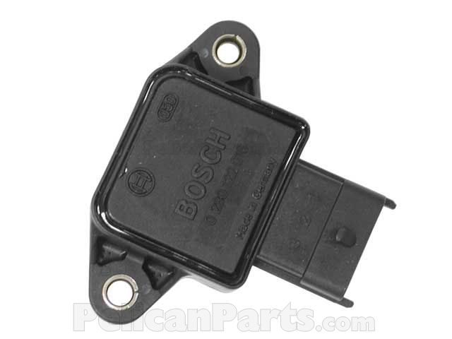

    When I look up the TB part online, I see a Throttle Position Switch listed as a related part. Could this be the problem?   The part is about 1.5”x1.5”x3/8” with a rotary connection for a spindle.  I can’t find it on the engine and can’t see any reason for it as it appears the TB is a completely integrated assembly with the sensor built in.  Is this part of the gas pedal? My car is a 2003.  Was there an earlier version with a mechanical throttle that this is for?

Your car has e-gas so the throttle position sensors (there are two inside) are integrated into the throttle body.

The sensor you showed above is for cabled t-body, not for your car.
Hi Ahsai.  thanks for the feedback.  I should have said this in my original post... Yesterday I reset the CEL and did the throttle calibration.  Afterwards, I checked the throttle position sensor target vs actual on my Durametric and everything appeared to be in sync ie actual = target.  I think this is the test you are referring to.  The car ran ok for a 5-10 miles then started acting up again.   I will check out the Bosch part.  hopefully its not the wiring.
thanks for the clarification on the other sensor!
