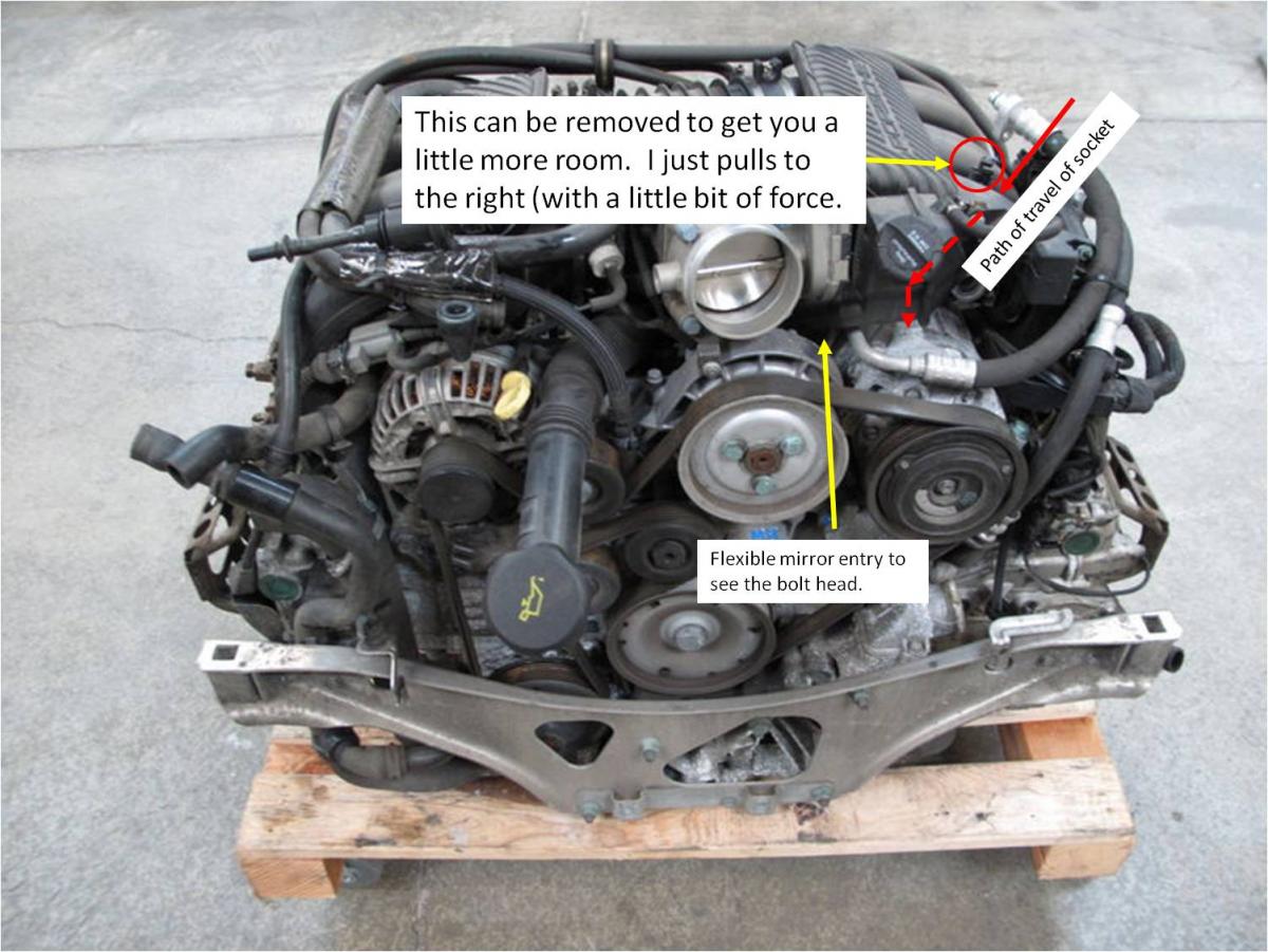

I had to use a shop mirror with a flexible tip, and a flashlight along with a socket, swivel head and 6" extension. I used the mirror to see the bolt head. Then with a lot of patience, I fished the socket, swivel head and extension down between the first and second ribs of the upper intake. Using the mirror, I danced the socket head until I was aligned with the bolt head. See the attached.
post-25004-0-90171700-1401204070_thumb.j
Edited by Hobbes
Thanks, your image is great (although that wooden pallet looks a bit scary B) ). Actually, after you have done this once, the next time is a walk in the park. Through the path which you marked red, it is reasonably easy to push your socket and extension to the bolt. Some kind of swivel is needed but the required degree difference is small, only 10 or so.
If you remove the temperature sensor that is located ((wedged ) between the air intake tubes then you have a pretty straight shot at it. A 13mm socket and a 6" extension is really all you need. The swivel is really only needed if you don't remove the sensor.
