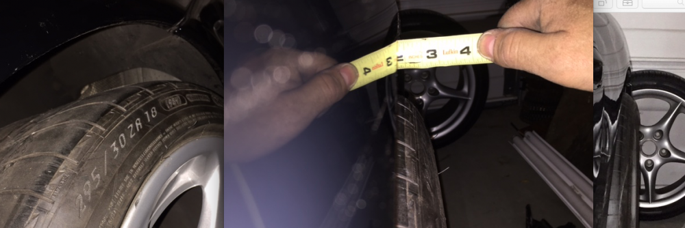

I'm running a 295/30/18's on the 10" ET65 Sport Design wheels. They fill out the wheel nicely, no rubbing on a 99 C4. 295's are generally spec'ed for 10"-11" widths.
Here is what I am running on my MY99 with Porsche Design Sport 8" front wheels and 10" rear wheels.
TireRack say 10" or 11" rears for these 295/30/18 tires
You will probably have rubbing issues with ET50. I tried a set for a while and the rubbed. Rolled the fenders and the still rubbed. Sold them and went with the ET65 and no problems. The ET 50 are basically set out 15mm farther than the ET65's. With any width on the tires they tend to rub. At least that was my experience. The rims I tried were LM's.

What I have got are 996.362.142.01 (CL seller said they are off turbo) with ET45 and 295/30/18 t tire. I have test fitted the rear now, and while the wheel fits and spins freely, the wheel protrudes about 20-25 mm axially beyond fender, and there is about 50mm vertical travel .  Is this worth a try  or a no-go (to high risk of collision with fender...)?
I would say it's not worth bothering.

Those will hit the first time you go over a major bump and then you will have body and/or tire damage.There are lots of Turbo Twists out there, check eBay and other sources.
