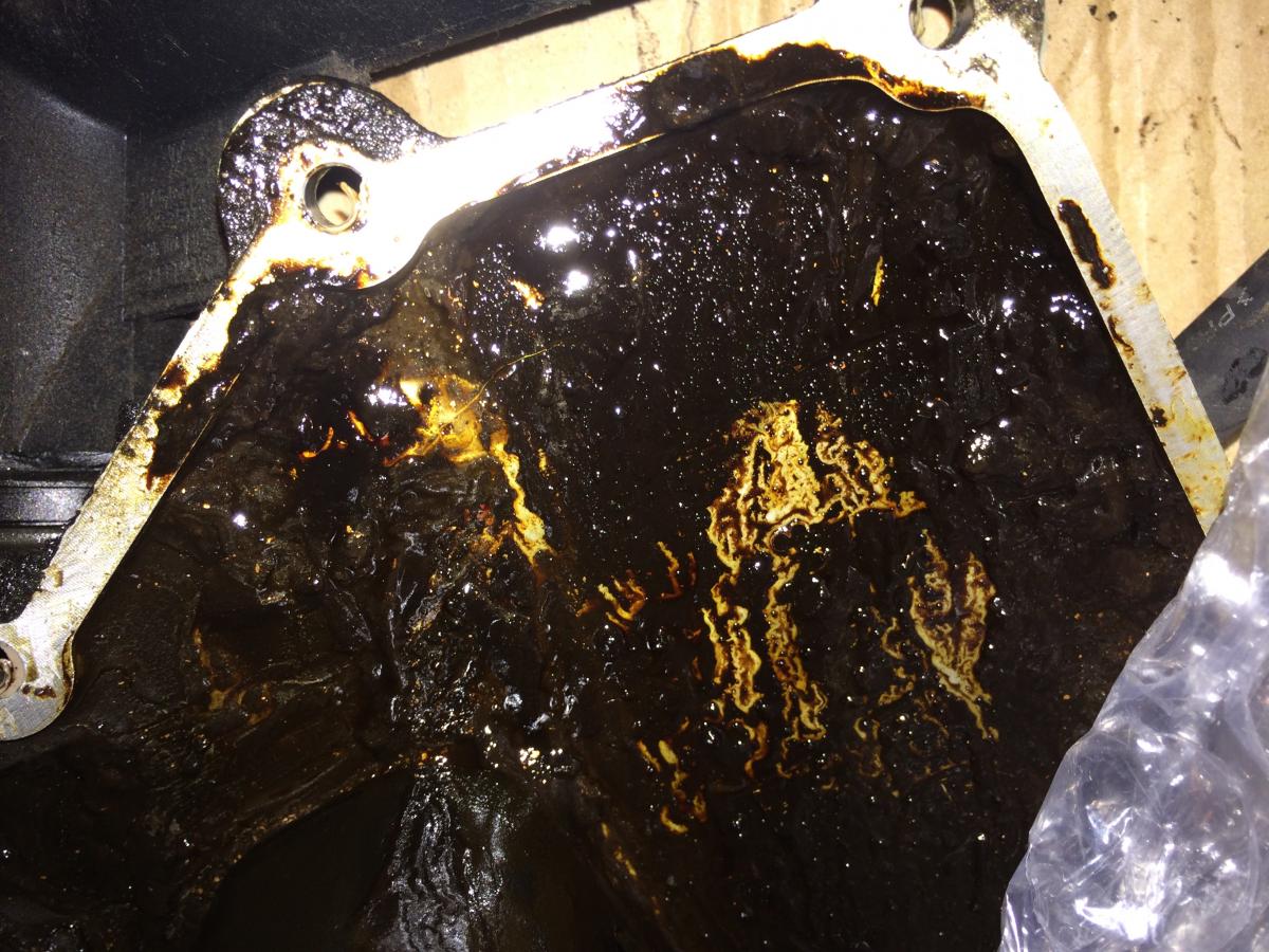

The original motor spun a bearing on rod 1 and the piston was coming in contact with the head.  Here are some photos
Milkshake from intermix
post-4971-0-91655400-1425250944_thumb.jp
Sludge in oil pan from intermix
post-4971-0-26993900-1425251035_thumb.jp
