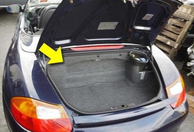

What ecu or dme would control the o2 sensors and where are they
The DME should be in your rear boot, behind a trim panel.
