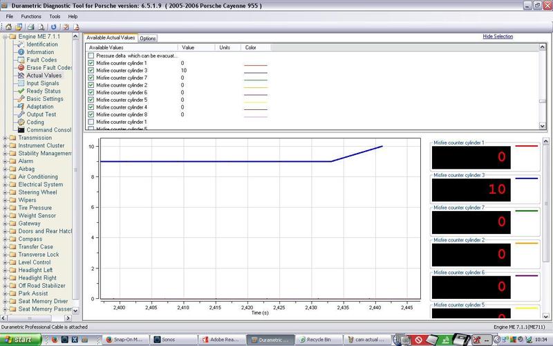

I ran some tests with my Durametric today. It looks like there are definitely problems with the camshaft or camshaft sensor. Camshaft deviation is not even reading on bank A.
The cylinder faults and misfires show something is clearly wrong with cylinder 3.
I am not skilled enough to further interpret these graphs, or know how to troubleshoot any further. Neither is my local Porsche dealer, who just wants to throw every Cayenne part at it until the problem stops.
Cylinder fault counter
Camshaft specified angle
Camshaft deviation
Camshaft actual angle
Misfire counter

Took the CTT to a independent specialist today. He hooked it up to his scanner / scope and not good news. He told me the cams were way out of deviation. Bank 2 was 15 deg out, Bank 1 was not even giving a measurement. Both cam sensors were giving readings. His opinion is that the rough running and misfires are most likely due to stretched timing chains.
He said the only real corrective action was to replace the timing chains and plastic parts, which meant dropping and stripping the engine - 30 plus hours and a few thousand in parts. Not much change from $10k.
Is there any way that the cam timing can be brought back into spec (+- 6 deg) without doing all that? No kind of mechanical adjustment that can be done on the cams without pulling or stripping the engine?
